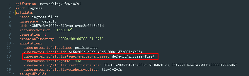

  • The first ingress information is written into annotations in clusters of v1.21.15-r0, v1.23.14-r0, v1.25.9-r0, v1.27.6-r0, v1.28.4-r0, v1.29.1-r0, and later. You can check kubernetes.io/elb.listener-master-ingress in the annotations of the existing ingresses.

      apiVersion: networking.k8s.io/v1
      kind: Ingress
      metadata:
        namespace: default
      spec:
        tls:
          - secretName: default-ns-secret-1
          - hosts:
              - 'example.com'
            secretName: default-ns-secret-2
