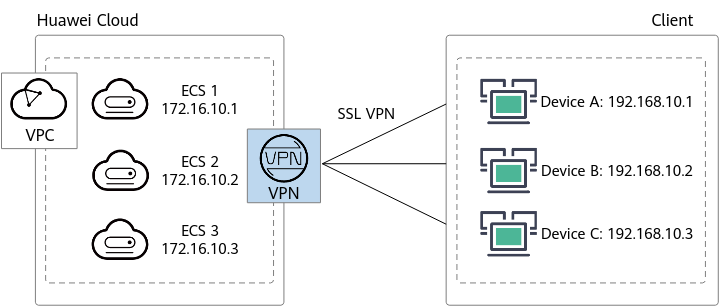

- Three ECS instances have been deployed in the VPC where the VPN gateway is located to simulate resource nodes on the cloud.
In this example, the flavor of each ECS is c6.large.2 (2 vCPUs, 4 GB memory, CentOS 8.0 - 64-bit system image).
- Three on-premises devices have been prepared to simulate clients.
In this example, device A and device B are Linux servers (4U8G, running the ubuntu-20.04.6-live-server-amd64 operating system), and device C is a PC (i7 processor, running the Windows 10 operating system).

This section describes how to use the iPerf3 tool to test the VPN gateway bandwidth. Figure 1 shows the networking diagram.
