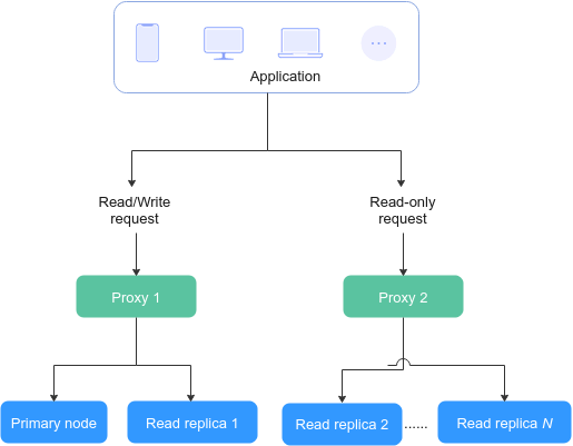

Read/write splitting enables read and write requests to be automatically routed through a proxy address. You can create a proxy instance after a TaurusDB instance is created. Thanks to the IP address of the proxy instance, write requests are automatically routed to the primary node and read requests are routed to read replicas and the primary node by user-defined weights.

When enabling read/write splitting for a DB instance, you need to select the nodes (including the primary node and read replicas) to be associated with the proxy instances.
- Different applications can connect to the DB instance through the IP addresses of different proxy instances. Read requests are routed to the proxy instances that applications connect to. You can also associate nodes with or remove nodes from proxy instances.
- A primary node or read replica can be associated with multiple proxy instances at the same time.
- In the read/write mode, all write requests are routed to the primary node, and read requests are routed to each node based on the read weights or active connections.
- In the read-only mode, only read requests can be routed to read replicas based on the read weights and active connections.
