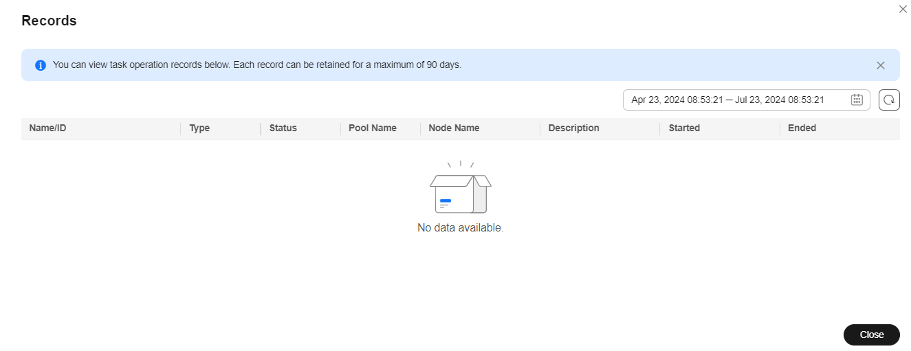

Check the node replacement records on the Records page. Running indicates that the node is being replaced. After the replacement, you can check the new node in the node list.

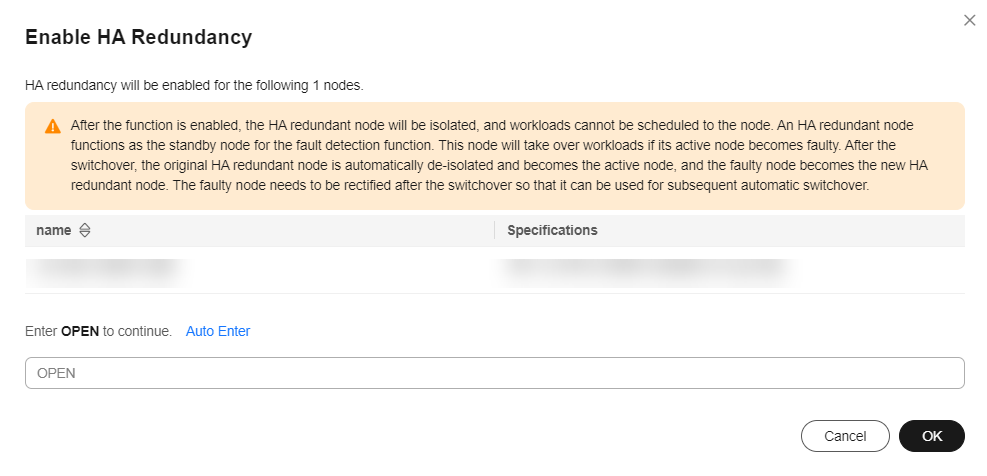

- HA redundant nodes function as standby nodes and work with node fault detection to ensure that the faulty nodes are automatically replaced by normal nodes in a resource pool. The replacement normally takes only a few minutes. After the replacement, the original HA redundant nodes will be de-isolated and become normal nodes, and the faulty nodes will be labeled as HA redundant nodes. Rectify the fault for future automatic switchover. After the faulty nodes are rectified, they become the new HA redundant nodes.

- Enabling HA redundancy
Select a node without any service as the HA redundant node. On the resource pool details page, click the Nodes tab, locate the target node, and click More > Enable HA Redundancy in the Operation column.
If you need to enable HA redundancy for nodes in batches, select the target nodes, and click Enable HA Redundancy above the list.
Figure 1 Enabling HA redundancyFigure 2 HA redundant node- 5% of the total nodes in a resource pool should be HA redundant nodes. For example, there are 20 nodes in a resource pool, then there should be one HA redundant node.

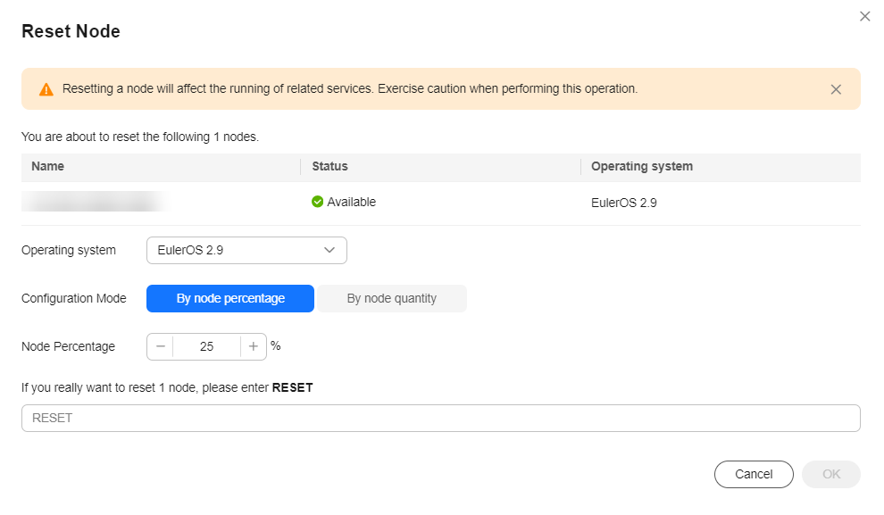

- Resetting a node: Perform this operation to upgrade the OS of the node. If an error occurs during node configuration update, reset the node to rectify the fault.
In the Nodes tab, locate the node you want to reset. Click Reset in the Operation column to reset a node. You can also select multiple nodes, and click Reset to reset multiple nodes.
Configure the parameters described in the table below.
Table 1 Parameters Parameter
Description
Operating system
Select an OS from the drop-down list box.
Configuration Mode
Select a configuration mode for resetting the node.
- By node percentage: the maximum ratio of nodes that can be reset if there are multiple nodes in the reset task
- By node quantity: the maximum number of nodes that can be reset if there are multiple nodes in the reset task
Check the node reset records on the Records page. If the node is being reset, its status is Resetting. After the reset is complete, the node status changes to Available. Resetting a node will not be charged.
Figure 5 Resetting a node- Resetting a node will affect running services.

Figure 6 Operation records - Restarting a node
