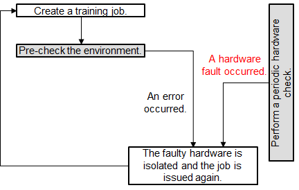

- Scenario 1: The environment pre-check fails, and the hardware is faulty. Then, ModelArts automatically isolates all faulty nodes and issues the training job again. Figure 1 Pre-check failure and hardware fault

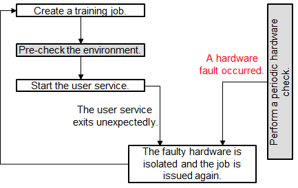

- Scenario 3: The environment pre-check is successful and the user service starts. A hardware fault occurs and the user service exits unexpectedly. Then, ModelArts automatically isolates all faulty nodes and issues the training job again. Figure 3 Service failure and hardware fault

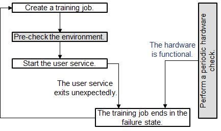

- Scenario 4: The environment pre-check is successful and the user service starts. The hardware is functional. A fault occurs in the user service, the training job ends in the failure state. Figure 4 Service failure and functional hardware

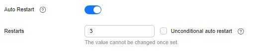

To enable fault tolerance check, enable auto restart when creating a training job.
- Configure fault tolerance check on the ModelArts Standard console:
Enable Auto Restart on the ModelArts management console. Auto Restart is disabled by default, indicating that the job will not be re-issued and the environment pre-check will not be enabled. After Auto Restart is enabled, the number of restart retries ranges from 1 to 128.
Figure 5 Auto Restart

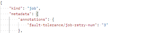

- Configure fault tolerance check using an API:
Enable auto restart upon a fault using an API. When creating a training job, configure the fault-tolerance/job-retry-num field in annotations of the metadata field.
If the fault-tolerance/job-retry-num field is added, auto restart is enabled. The value can be an integer ranging from 1 to 128. specifying the maximum number of times that a job can be re-issued. If this hyperparameter is not specified, the default value 0 is used, indicating that the job will not be re-issued and the environment pre-check will not be enabled.
Figure 6 Setting the API
