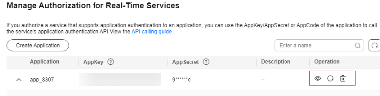

- Viewing, resetting, or deleting an application
Query plaintext, reset, or delete an application by clicking the corresponding icon in the Operation column of the application. After an application is created, the AppKey and AppSecret are automatically generated for application authentication.
Figure 2 Query Plaintext, Reset, or Delete
- Unbinding a service
Click
next to the target application name to view the real-time services bound to the application. Click Unbind in the Operation column to cancel the binding. Then, this API cannot be called. - Obtaining the AppKey/AppSecret
Application authentication is required for API calling. The AppKey and AppSecret are automatically generated during application creation. Click
in the Operation column of the application in the Manage Authorization of Real-Time Services dialog box to view the complete AppSecret.

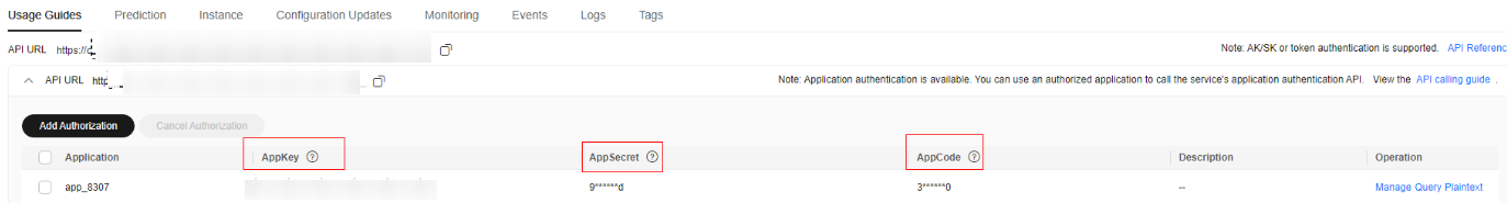

You can obtain the API URL (url of the real-time service), AppKey/AppSecret (app_key and app_secret), and AppCode (app_code) from the Usage Guides tab on the service details page. Use the API URL for application authentication in the second line of the figure.
