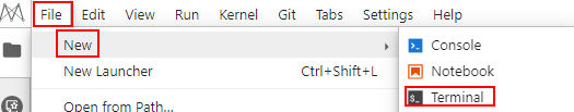

- Create a notebook instance. When the instance is running, click Open in the Operation column. The JupyterLab page is displayed.
- Choose File > New > Terminal. The Terminal page is displayed. Figure 1 Terminal

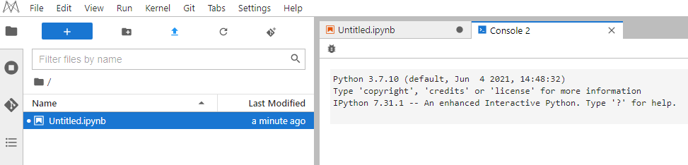

Creating a Notebook File and Accessing the Console
A console is a Python terminal, which is similar to the native IDE of Python, displaying the output after a statement is entered.
On the JupyterLab homepage, click a proper AI engine in the Console area to create a notebook file.
The AI engines supported by each notebook instance vary depending on the runtime environment. The following figure is only an example. Select an AI engine based on site requirements.
After the file is created, the console page is displayed.

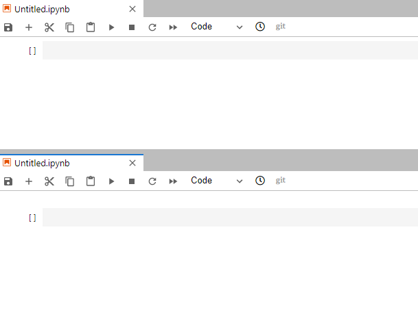

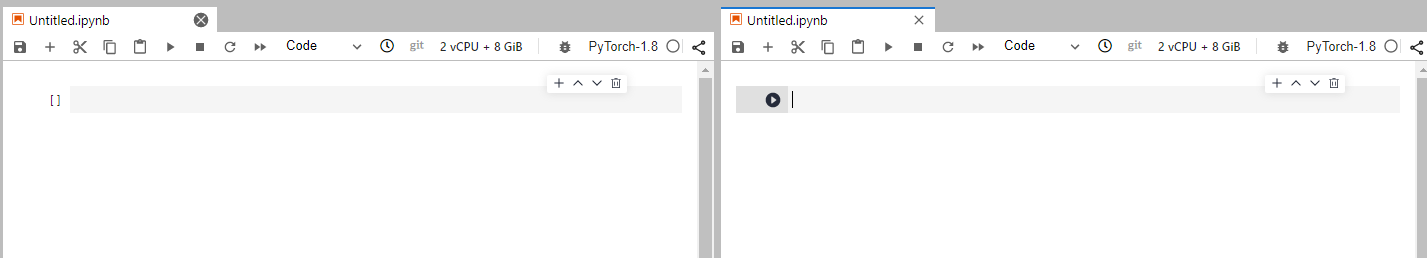

JupyterLab allows you to open multiple notebook instances or files (such as HTML, TXT, and Markdown files) in one window and displays them on different tab pages.
In JupyterLab, you can customize the display of multiple files. In the file display area on the right, you can drag a file to adjust its position. Multiple files can be concurrently displayed.
When writing code in a notebook instance, you can create multiple views of a file to synchronously edit the file and view execution results in real time.
To open multiple views, open an IPYNB file and choose File > New View for Notebook.

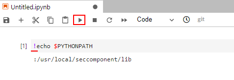

Before coding in the code area of an IPYNB file in JupyterLab, add an exclamation mark (!) before the code.
For example, install an external library Shapely.
!pip install Shapely
For example, obtain PythonPath.
!echo $PYTHONPATH

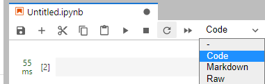

| There are four options in the drop-down list: Code (Python code), Markdown (Markdown code, typically used for comments), Raw (a conversion tool), and - (not modified) |

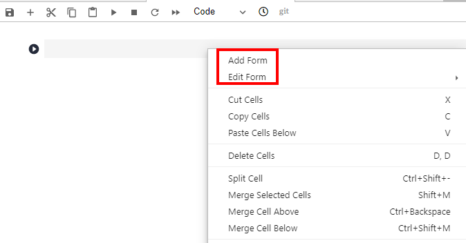

- The Add Form and Edit Form buttons are available only to the shortcut menu of code cells, as shown below. Figure 11 Viewing a code cell
- After opening new code, add a form before editing it. Figure 12 Shortcut menu of code cells

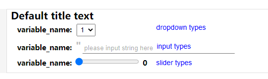

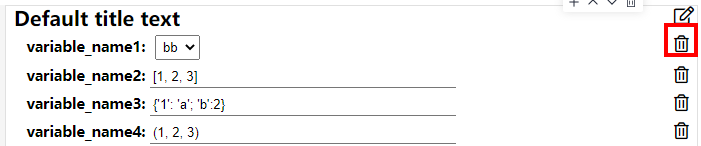

- If you click Add Form, a code cell will be split into the code and form edit area. Click Edit on the right of the form to change the default title. Figure 13 Two edit areas
- If you click Edit Form, four sub-options will be displayed: Add new form field, Hide code, Hide form, and Show All.
Table 5 Edit Form sub-options Edit-Form Sub-option
Description
Add new form field

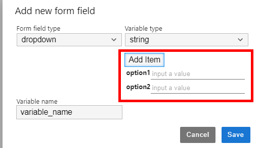

- The form field types include dropdown, input, and slider, as shown in Figure 14. Each time a field is added, the corresponding variable is added to the code and form areas. If a value in the form area is changed, the corresponding variable in the code area is also changed.
NOTE:When creating a dropdown form, click ADD Item and add at least two items, as shown in Figure 15.
- If the form field type is set to dropdown, the supported variable types are raw and string.
- If the form field type is set to input, the supported variable types are boolean, date, integer, number, raw, and string.
- If the form field type is set to slider, the minimum value, maximum value, and step can be set.

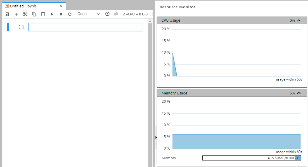

Monitoring Resources
To obtain resource usage, select Resource Monitor in the right pane. The CPU usage and memory usage can be viewed.
