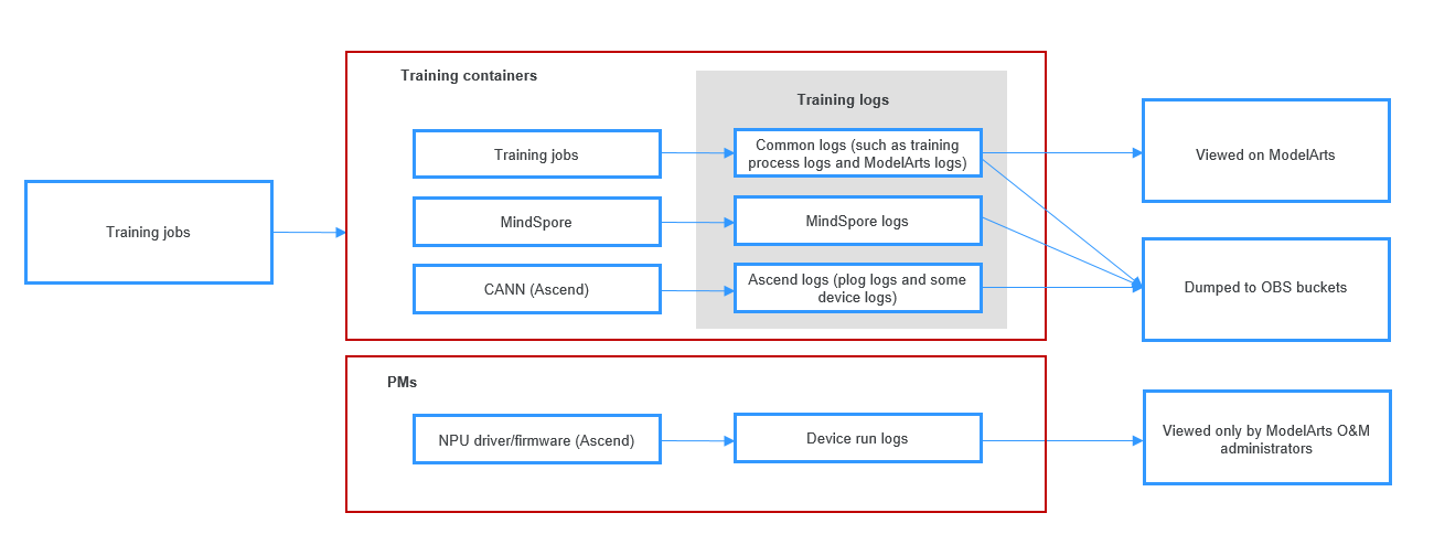

Training logs record the runtime process and exception information of training jobs and provide useful details for fault location. The standard output and standard error information in your code are displayed in training logs. If you encounter an issue during the execution of a ModelArts training job, view logs first. In most scenarios, you can locate the issue based on the error information reported in logs.
Training logs include common training logs and Ascend logs.
- Common Logs: When resources other than Ascend are used for training, only common training logs are generated. Common logs include the logs for pip-requirement.txt, training process, and ModelArts.
- Ascend Logs: When Ascend resources are used for training, device logs, plog logs, proc log for single-card training logs, MindSpore logs, and common logs are generated.
Separate MindSpore logs are generated only in the MindSpore+Ascend training scenario. Logs of other AI engines are contained in common logs.
Retention Period
Logs are classified into the following types based on the retention period:
- Real-time logs: generated during training job running and can be viewed on the ModelArts training job details page.
- Historical logs: After a training job is completed, you can view its historical logs on the ModelArts training job details page. ModelArts automatically stores the logs for 30 days.
- Permanent logs: These logs are dumped to your OBS bucket. When creating a training job, you can enable persistent log saving and set a job log path for dumping.
Real-time logs and historical logs have no difference in content. In the Ascend training scenario, permanent logs contain Ascend logs, which are not displayed on ModelArts.
