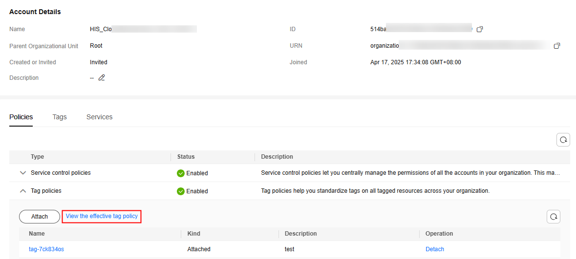

To view the effective tag policy for the root OU, other OUs, and accounts of an organization on the management console, use the following procedure:
Procedure
- Go to the Organizations console and access the Organization page.
- Click the root OU, specific OU, or account of your organization. You can view its details on the right of the organization tree.
- Click the Policies tab.
- Expand the tag policy list and click View the effective tag policy above the list. The effective tag policy is presented in JSON. Figure 1 Viewing the effective tag policy
