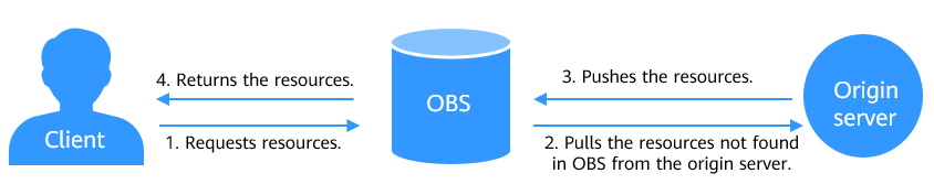

Process of Back to Source by Mirroring
If the data you requested is not found in a bucket that has a back-to-source by mirroring rule configured and the request matches the rule, OBS will pull the data from its origin server and return it to you. This process does not interrupt services. Therefore, you can use this function to seamlessly migrate data from the origin server to OBS without being sensed by users, at low costs. Figure 1 shows the process of back to source by mirroring.
