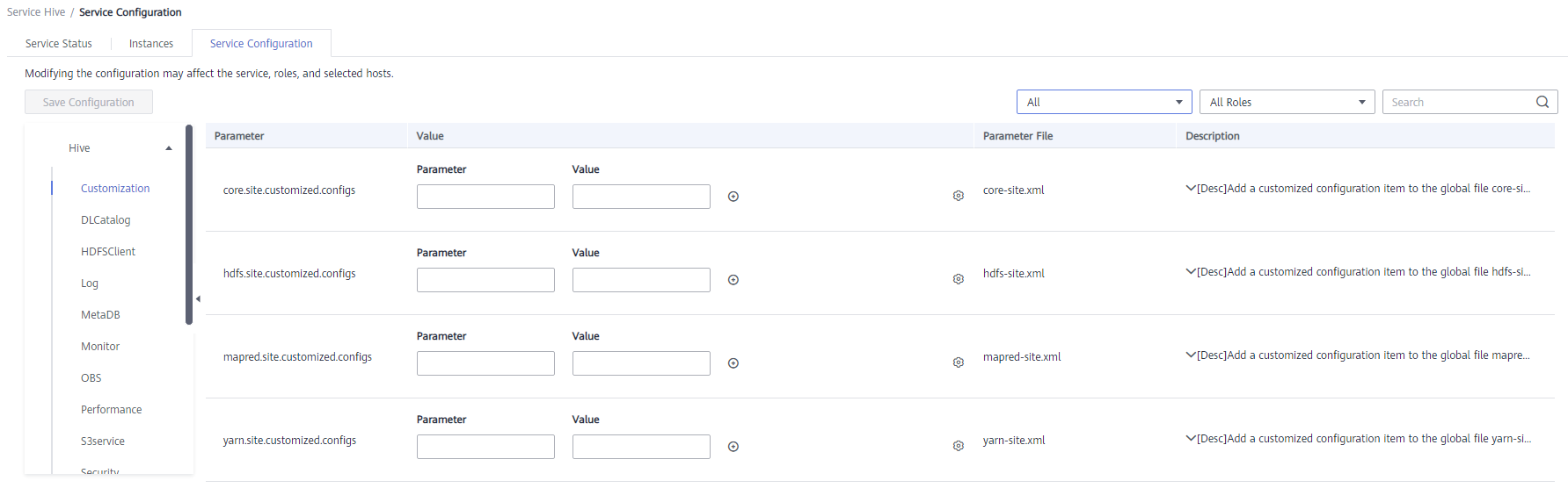

Hive Configuration
  1. Log in to the MRS console.
  2. In the navigation pane on the left, choose Active Clusters and click the target cluster name.
  3. Choose Components > Hive > Service Configuration.
  4. Switch Basic to All, and search for and set the following parameters:
    Table 1 Data encryption parameters
    Parameter
    Value
    Description
    fs.obs.server-side-encryption-type
    SSE-KMS
    • SSE-KMS: KMS keys are used for encryption and decryption
    • NONE: The encryption function is disabled.
    fs.obs.server-side-encryption-key
    (Optional) This parameter indicates an ID of the KMS key used for encryption.
    If fs.obs.server-side-encryption-type is set to SSE-KMS and this parameter is not set, OBS uses the default KMS key for encryption.
    fs.obs.connection.ssl.enabled
    true
    Whether to establish a secure connection with OBS.
    • true: The secure connection is enabled. To use OBS encryption and decryption, this parameter must be set to true.
    • false: The secure connection is disabled.
  5. Click Save Configuration and save the modified parameters as prompted.
