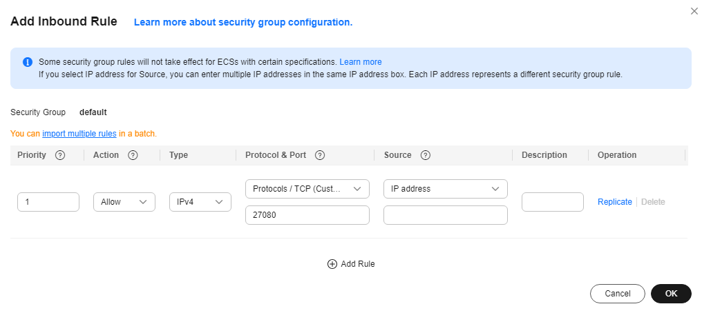

- Allow TCP traffic on port 27080. You can do that by adding an inbound rule to the security group of the Linux server. For the rule, set Source to the IP address of the Windows server you use to remotely access the MgC Agent console.

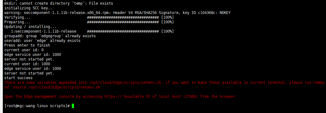

- Run the MgC Agent installation script.
./install.sh
- Enter a private IP address of the Linux server. The IP address will be used for accessing the MgC Agent console. If the entered IP address is not used by the Linux server, the system will prompt you whether to use any public IP address of the Linux server as the MgC Agent access address.
- Check if the message shown in the following figure is displayed. If it is, the MgC Agent for Linux has been installed. The port in the following figure is for reference only. Note the actual port returned. Generally, the port is 27080.
Update environment variables.
source /opt/cloud/Edge/scripts/setenv.sh

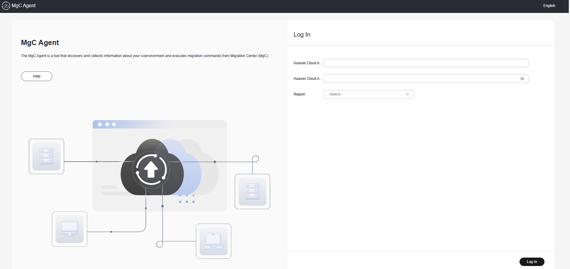

- On the Windows server for which an inbound rule is added to the security group of the server where the MgC Agent is installed, open a browser and enter https://<IP-address-entered-in-step-7>:<port-obtained-in-step-8> in the address box. For example, if the IP address entered in step 7 is 192.168.x.x and the port returned in step 8 is 27080, the MgC Agent access address is https://192.168.x.x:27080. Open the MgC Agent console, enter the AK/SK pair of your Huawei Cloud account, select a region, and click Log In.
If there are access problems, check the IP address entered in the address box and the inbound rule settings of the security group of the Linux server with the MgC Agent installed.

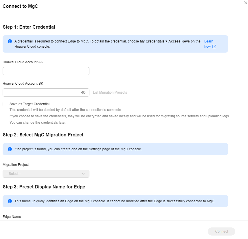

Connecting the MgC Agent to MgC
- Use the AK/SK pair of your Huawei Cloud account to log in to the MgC Agent console.
- On the Overview page, click Connect in the upper right corner. The Connect to MgC page is displayed on the right.
- In Step 1: Enter Credential, enter the AK/SK pair of the Huawei Cloud account used to access MgC and click List Migration Projects. After the MgC Agent is authenticated using the entered AK/SK pair, you can go to the next step. If the system displays a message indicating that the AK/SK pair is incorrect, try to rectify the fault by following the instructions in What Can I Do If the AK/SK Verification Fails?
If your source servers need to be migrated, the entered AK/SK pair must have permissions to use SMS. For details, see SMS Custom Policies.
Determine whether to save the entered AK/SK pair as the target credential which will be used for migrating your workloads to Huawei Cloud.
- If you select No, the entered AK/SK pair will be deleted after the MgC Agent is connected to MgC.
- If you select Yes, the entered AK/SK pair will be encrypted and saved locally after the connection to MgC is established. When you migrate workloads to Huawei Cloud, the AK/SK pair will be delivered to SMS-Agent on the source servers for executing the migration.
- In Step 2: Select MgC Migration Project, select a migration project from the project drop-down list. The MgC Agent will report the collected information about your source resources to this project.
- In Step 3: Preset MgC Agent Name, specify a name for the MgC Agent, which will be displayed on the MgC console, and click Connect. Confirm the connection to MgC, and click OK.
After the MgC Agent is connected to MgC, the name you specified here cannot be modified.
- If Connected shows up on the overview page, the connection to MgC is successful.
