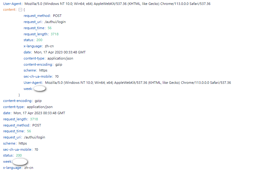

Examples
| Search Requirement | Search Statement |
| Search for logs whose User-Agent field value contains Mon, 17 Apr 2023. | User-Agent:#"Mon, 17 Apr 2023" |
| Search for logs whose User-Agent field value contains Mozilla/5.0. | User-Agent:#"Mozilla/5.0" |
| Search for logs whose week field value contains Monday. | week:#"Monday" |
