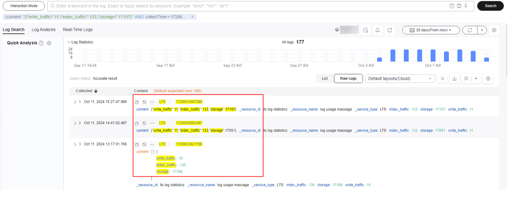

- On the Log Search tab page, perform the following operations. For more operations, see Common Log Search Operations.
- Under Log Statistics, view the bar chart showing the log quantity in different time segments. The scale of the log quantity is displayed on the left.
- In the log content area, hover the cursor over a field and click the log content in blue. You can search for logs by copying, adding to query, and excluding from query.
- In the log content area, you can select a list or raw log to display its log content.
The log highlighting mechanism works as follows: Once a log meets the search criteria, the system identifies the log's strings that match these criteria and applies highlight tags to the matching sections, making them visibly highlighted on the page. However, when the query criteria are complex, particularly involving OR relationships, content that does not actually match the criteria may also be highlighted on the page.

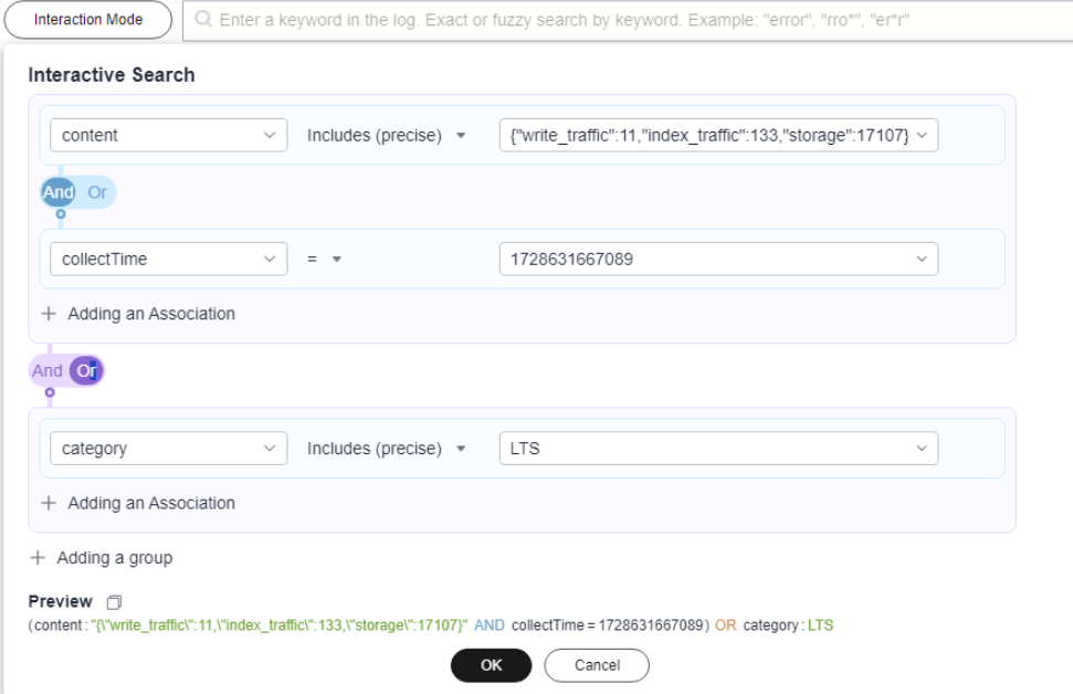

Interactive Mode
Before using the interactive mode function, ensure that logs are properly reported and structured, and indexing have been configured. For details, see Using ICAgent to Collect Host Logs and Configuring Log Indexing.
If you have not configured ICAgent structuring parsing when configuring log ingestion to LTS, you can configure ICAgent or cloud configuring parsing for the target log stream separately. ICAgent structuring parsing is recommended. For details, see Configuring ICAgent Structuring Parsing.
The interactive search function generates simple search statements, allowing you to set search criteria and specify query filter rules on the LTS console to filter log records. For more functions or nested queries, enter SQL statements manually. For details, see Using SQL Analysis Syntax.
- Click Interaction Mode in front of the search box to access the interactive search page.
- Select a log search field and desired criteria from the drop-down list. The corresponding values of the field will be displayed in the search box. Add associations or groups to customize your search mode.
- The drop-down list displays index fields, structured fields, and system reserved fields.
- And indicates that all criteria must be met.
- Or indicates that at least one of the criteria must be met.
For example, you can select fields such as content, collectTime, and category and set different conditions. Then you can preview the search statement at any time and modify the search criteria with ease.
(The following figure is for reference only.)
(content:"{\"write_traffic\":11,\"index_traffic\":133,\"storage\":17107}" AND collectTime=1728631667089) OR category:LTS
- After setting the parameters, click OK. LTS searches logs based on your search statement and displays the search results on the Log Search tab page.
