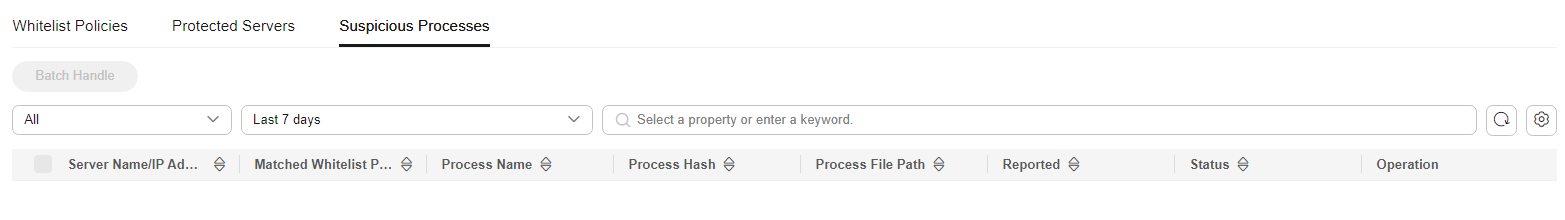

- Click the Suspicious Processes tab. Figure 1 Viewing suspicious processes
- Determine whether a suspicious process can be trusted based on its information, such as the hash value and file path.
