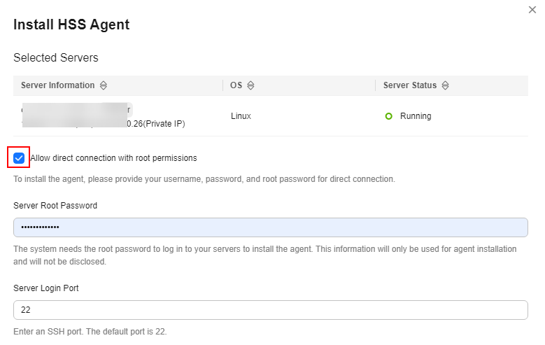

Using a Username and Password to Install the Agent on a Huawei Cloud Server
- Log in to the HSS console.Log in to the management console.
- Click
in the upper left corner and select a region or project. - In the navigation pane, choose .
- (Optional) If you have enabled the enterprise project function, select an enterprise project from the Enterprise Project drop-down list in the upper part of the page to view its data.
- In the upper right corner of the page, click Install HSS Agent.
- Select ECS and click Configure Now.
- Configure installation parameters as follows:
- Install Mode: Select GUI.
- Server Authentication Mode: Select Account and password.
- Scale: Select Single.

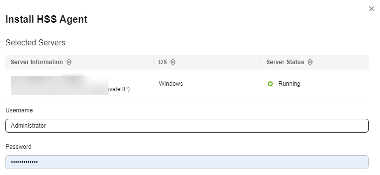

- Select a server and click Next.
- Enter a username and password as prompted.
- Confirm the information and click OK.
You can view the Agent Status column to check the agent installation progress. If the Agent Status is Online, the agent has been installed.

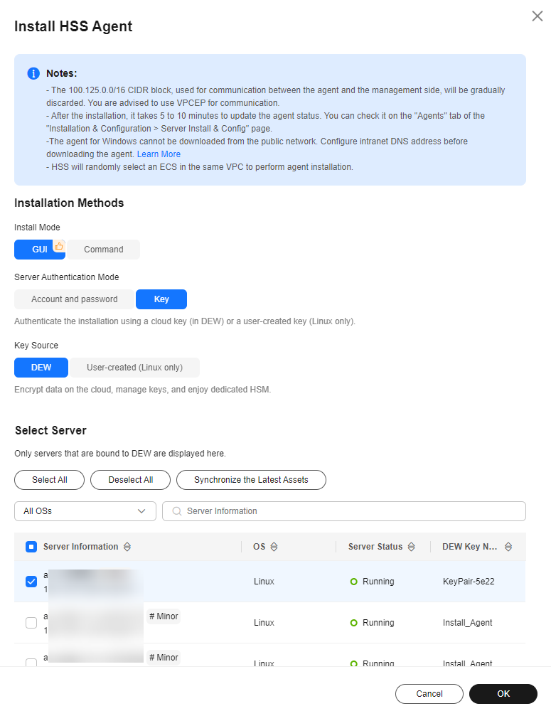

- Server Authentication Mode: Select Key.
- Key Source: Select DEW
- Select servers and click OK.
In the server list, only the servers bound to DEW are displayed.
Figure 4 Selecting servers
- In the row of a server, check its agent installation progress in the Agent Status column.

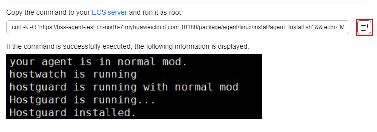

- Install the agent as prompted.
- On the console page, click
in the Install HSS Agent dialog box to copy the installation command. Figure 6 Copying the installation command

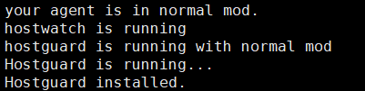

- Log in to the server as the root user and paste the installation command.
If the command output shown in Figure 7 is displayed, the agent has been installed.
Figure 7 Agent installed
- Wait for 5 to 10 minutes and return to the HSS console. On the Server Install & Config page, click the Agents tab, and click Servers with Agents. Check the agent status of the target server.

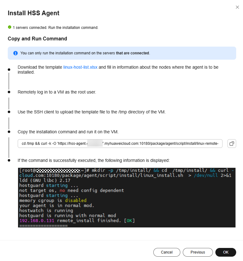

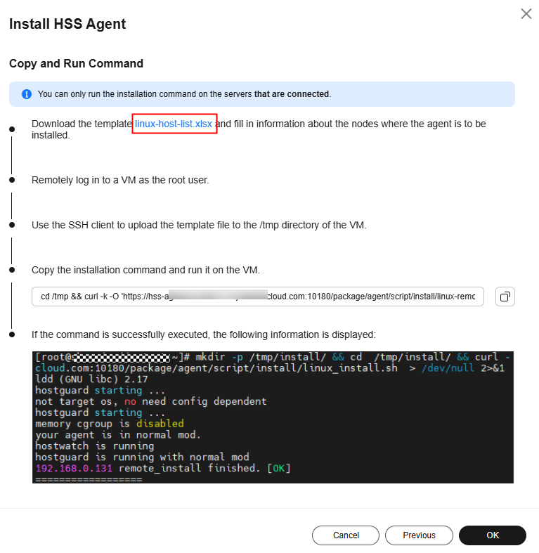

Perform the following operations on any server:
- On the console, click linux-host-list.csv in the Install HSS Agent dialog box to download the template.
Figure 8 Downloading linux-host-list.csv
- Enter the server information based on the requirements in the linux-host-list.csv template and save the template.
Ensure that the entered server verification information is consistent with the verification mode selected in 7.

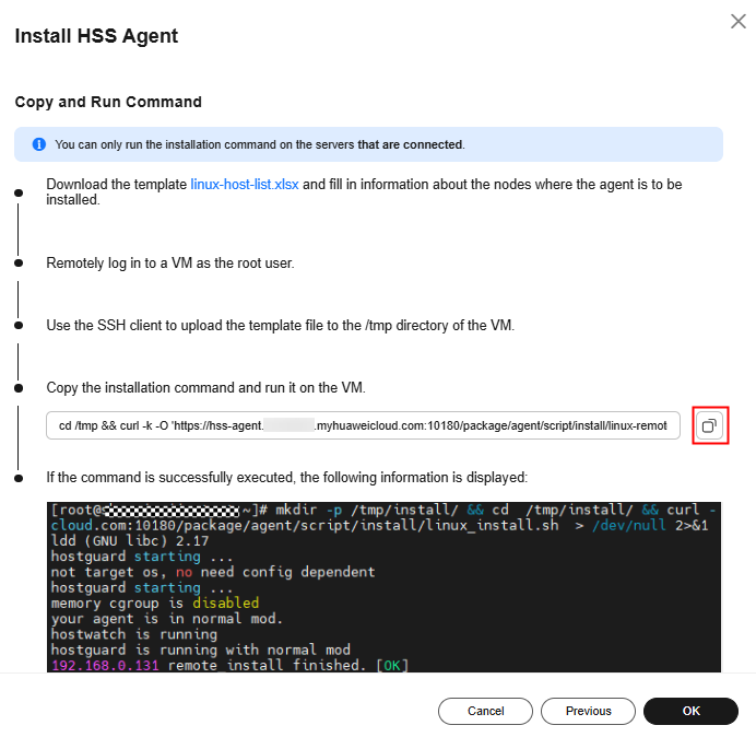

- Use the root account to remotely log in to any target server.
- Use the SSH client to upload the linux-host-list.csv file to the /tmp directory on the server.
- Return to the HSS console. In the Install HSS Agent dialog box, click
to copy the installation command. Figure 9 Copying the installation command

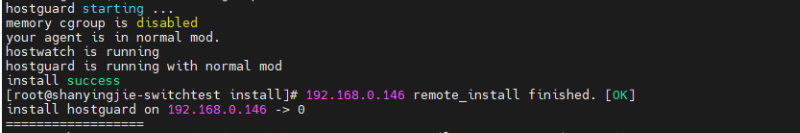

- Paste and run the installation command on the server to install the agent.
If the information shown in Figure 10 is displayed, the installation is complete.
Figure 10 Agent installed

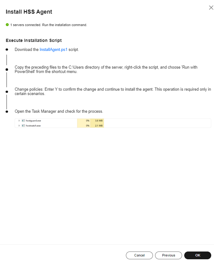

- On the console, click installAgent.ps1 in the Install HSS Agent dialog box to download the installation script.
Figure 11 Downloading installAgent.ps1
- Log in as user Administrator to the server where the agent is to be installed.
- Copy the installAgent.ps1 file to the C:\Users directory of the server where the agent is to be installed.

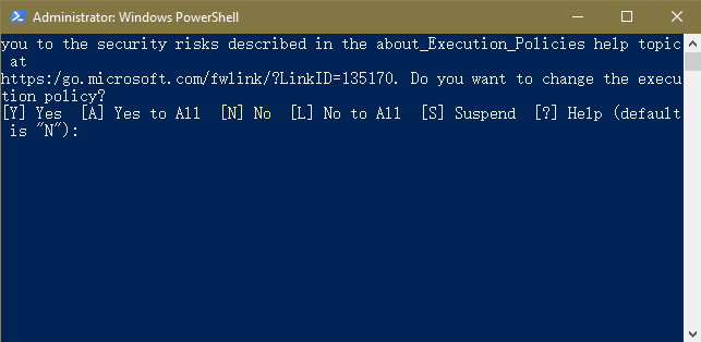

- Right-click installAgent.ps1 and choose Run with PowerShell.
- (Optional) In the dialog box that is displayed, enter Y to run the script to install the agent.
If no dialog box is displayed, skip this step.
Figure 12 Changing the execution policy

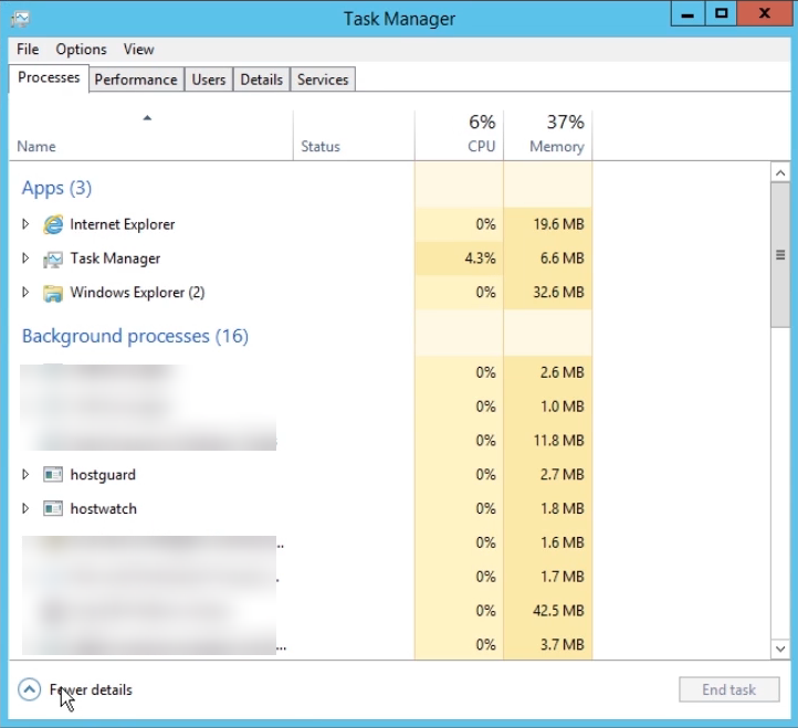

- After the execution, open the Task Manager and check whether hostguard.exe and hostwatch.exe exist. If they do, the agent has been installed.
Figure 13 Agent installed

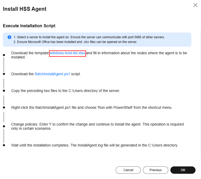

- On the console, click windows-host-list.xlsx in the Install HSS Agent dialog box to download the template to the local PC.
Figure 14 Downloading windows-host-list.xlsx
- Enter server information based on the requirements in the windows-host-list.xlsx template and save it.
in the Install HSS Agent dialog box to copy the installation command. Figure 17 Copying the installation command
- Use the root account to log in to the server under account B. Paste and run the installation command.
If the command output shown in Figure 18 is displayed, the agent has been installed.
Figure 18 Agent installed
Figure 19 Downloading linux-host-list.csv
- In the linux-host-list.csv template, fill in the information about account B's servers that need to be managed, and save the information.
- Use the root account to remotely log in to any of account B's servers that need to be managed.
to copy the installation command. Figure 20 Copying the installation command
If the information shown in Figure 21 is displayed, the installation is complete.
Figure 21 Agent installed
Figure 22 Downloading installAgent.ps1
- Log in as user Administrator to the server that is to be managed and belongs to account B.
- Copy the installAgent.ps1 file to the C:\Users directory of the server to be managed.
Figure 23 Changing the execution policy
Figure 24 Agent installed

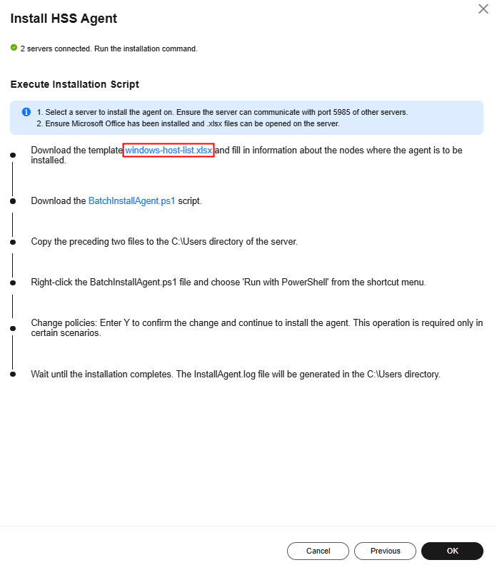

Figure 25 Downloading windows-host-list.xlsx
- In the windows-host-list.xlsx template, fill in the information about account B's servers that need to be managed, and save the information.

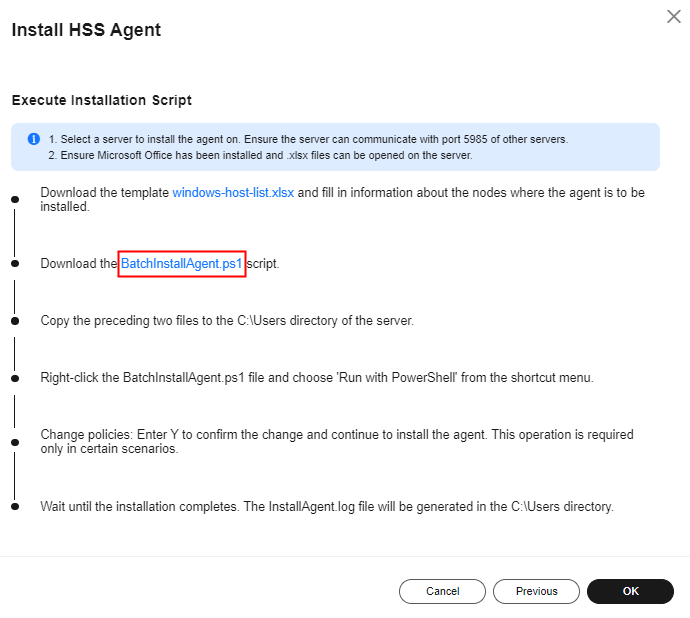

- Return to the HSS console and click BatchInstallAgent.ps1 to download the installation script.
Figure 26 Downloading BatchInstallAgent.ps1
- Log in as user Administrator to a server that is to be managed and belongs to account B.
- Copy and paste the windows-host-list.xlsx and BatchInstallAgent.ps1 files to the C:\Users directory on any of account B's servers to be managed.
- Right-click BatchInstallAgent.ps1 and choose Run with PowerShell.
Figure 27 Changing the execution policy
- After the script is executed successfully, check whether the BatchInstallAgent.log file exists in C:\Users\Administrator.
If the BatchInstallAgent.log file exists, the agent has been installed.
