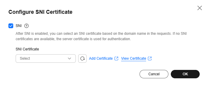

Enabling SNI for an HTTPS Listener
  1. Go to the load balancer list page.
  1. On the displayed page, locate the load balancer and click its name.
  2. Click Listeners, locate the listener, and click its name.
  3. On the Summary tab, click Configure below SNI.
  4. Enable SNI and select an SNI certificate.
    Figure 1 Configuring an SNI certificate
  5. Click OK.
