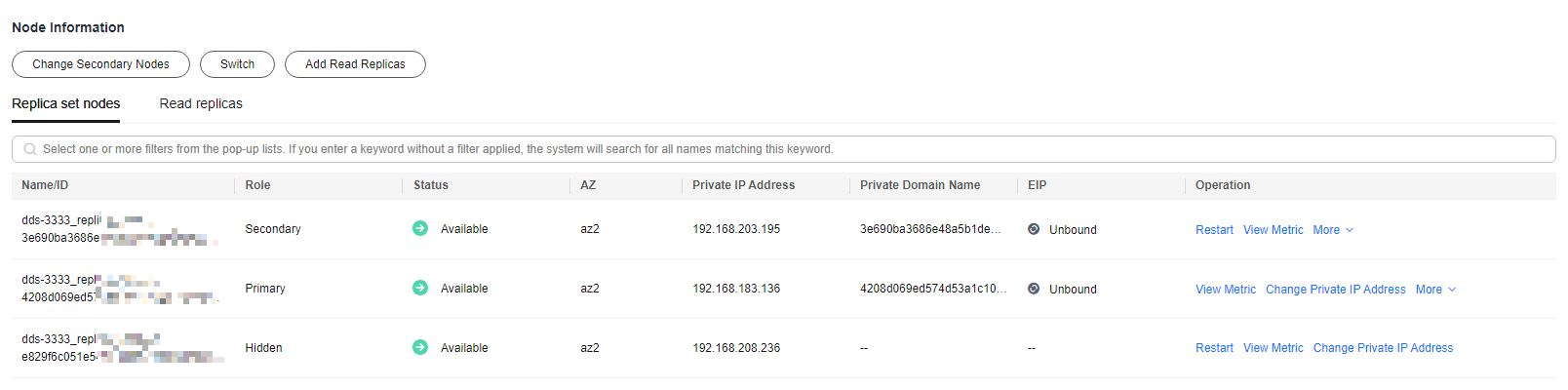

Performing a Primary/Secondary Switchover
- Click
in the upper left corner and select a region and a project. - Click
in the upper left corner of the page and choose Databases > Document Database Service. - On the Instances page, click the replica set instance.
- In the Node Information area on the Basic Information page, click Switch. Figure 1 Primary/Secondary switchover
- In the displayed dialog box, click Yes.
- Check the result.
- During the switchover process, the DB instance status changes to Switchover in progress. After the switchover is complete, the status is restored to Available.
- In the Node Information area, you can view the switchover result.
- After the switchover, the previous primary node becomes the secondary node. You need to reconnect to the primary node. For details, see Connecting to a DB Instance.

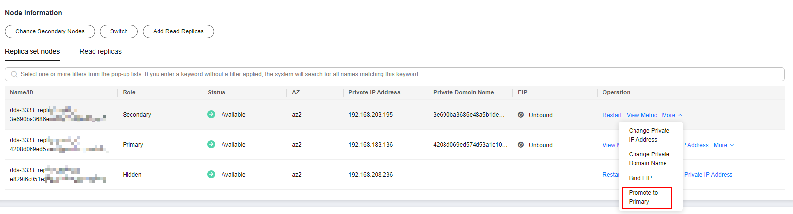

Forcibly Promoting a Secondary Node to the Primary
- Click
in the upper left corner of the page and choose Databases > Document Database Service. - On the Instances page, locate the target replica set instance and click its name.
- In the Node Information area on the Basic Information page, locate a target node whose role is Secondary and click Promote to Primary in the Operation column. Figure 2 Promote to Primary
- Check the result.
- In the Node Information area on the Basic Information page, you can view the result.
