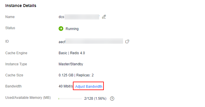

  5. In the Instance Details area of the DCS instance, click Adjust Bandwidth next to Bandwidth.
    Figure 1 Adjusting bandwidth

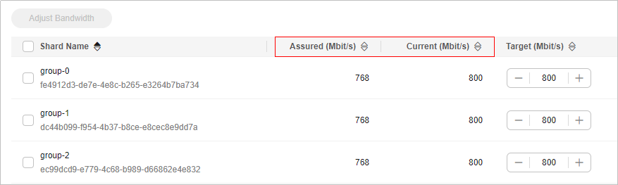

On the page for manually adjusting the bandwidth, you can view Assured and Current bandwidth of each shard. Current displays the latest bandwidth.
Figure 2 Viewing bandwidth

    For example, Figure 2 shows a cluster instance with three shards. The adjusted bandwidth of each shard is 800 Mbit/s, and the total bandwidth of the cluster instance is 2,400 Mbit/s.
