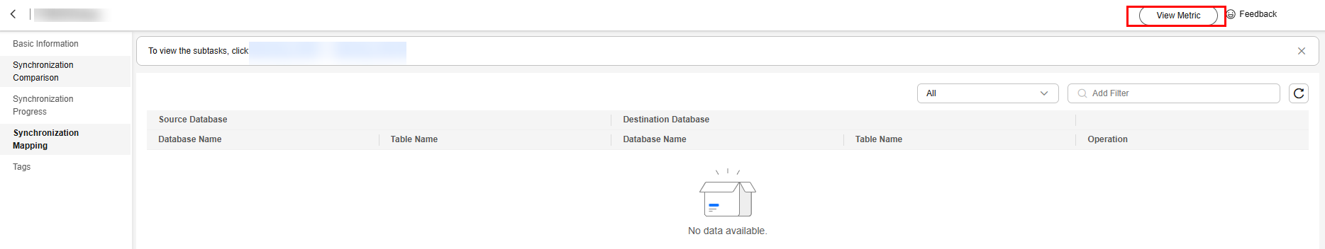

- Check the number of tables in the DRS task.
Click the DRS task name to view its details. Choose Synchronization Mapping and view the number of tables. A job in DataArts Migration provides an optimal performance when the number of tables in the job is less than 50.
Figure 1 Checking the number of tables in a DRS task - View the maximum amount data that can be synchronized concurrently.

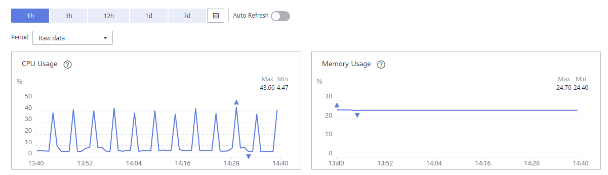

Go to the DRS task monitoring page and view the monitoring metrics, mainly the Rows Written into Destination Database per Second metric. In addition, check whether the DRS task has a latency.
A job with 8 CUs in DataArts Migration can synchronize 8,000 records per second. You are advised to configure an independent job for a table with a large amount of data.
Figure 2 Viewing monitoring metricsFigure 3 Viewing metric details - Create jobs based on the customer's requirements.

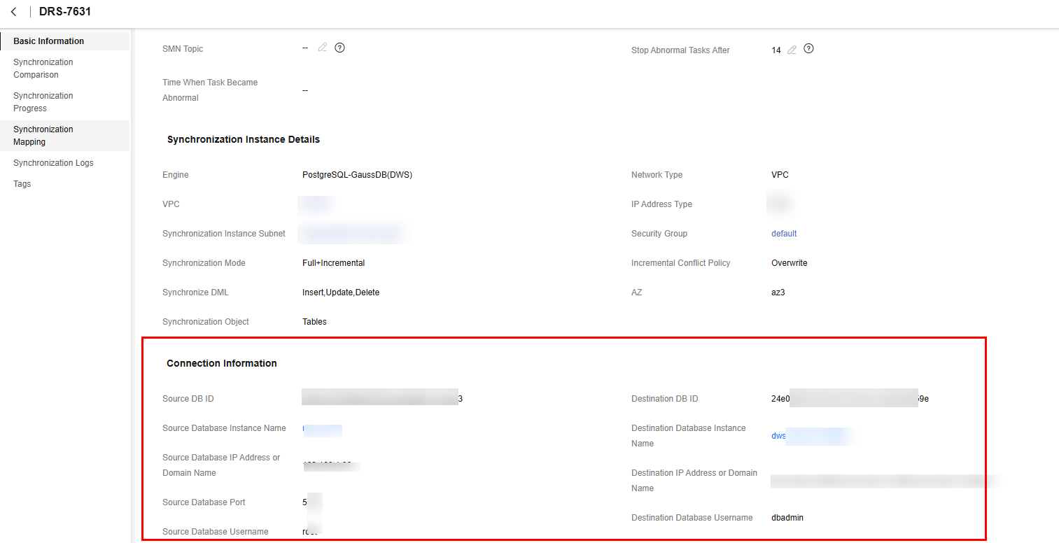

Enable communications between the migration resource group and the data source. In the basic information of the DRS task, view the data source configuration. Enable the communications by following corresponding instructions
Figure 4 Viewing the data source configuration

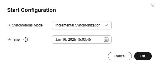

- Before starting a migration job, suspend the DRS job to avoid write conflicts.
Start the migration job based on the obtained security location. You can set the start time of the migration job to a time earlier (30 minutes recommended) than the security location to avoid data loss.
For example, if the obtained DRS security location timestamp is 2024-11-29 12:00:00, you can set the time for starting the migration job to 2024-11-29 11:30:00.
Figure 5 Setting the time for starting the migration jobAfter the migration job is started and is running stably, you can stop the DRS task.
