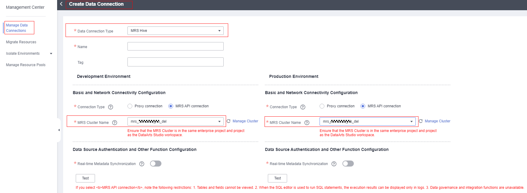

      For clustered data sources, such as MRS, GaussDB(DWS), RDS, MySQL, Oracle, and ECS, you can create data connections in Management Center to distinguish data lake services in the development environment from those in the production environment. The data lake is automatically switched during development and production. Therefore, you need to prepare two sets of data lake services that have the same version, specifications, components, region, VPC, subnet, and other related configurations. For details, see Creating a DataArts Studio Data Connection.
      When creating a data connection, you can select different clusters for the development environment and production environment to isolate them.
      Figure 2 Selecting different clusters during data connection creation

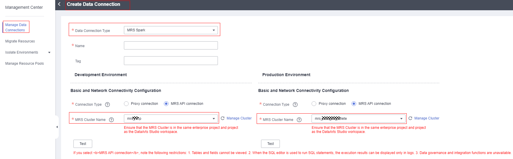

      For GaussDB(DWS), MRS Hive, and MRS Spark, if you select the same cluster when creating a data connection (as shown in Figure 3), you must configure database mapping on the Configure Data Source Resource Mapping page shown in Figure 4 to isolate the development and production environments. For details, see DB configuration.
      Figure 3 Selecting the same cluster during data connection creation
