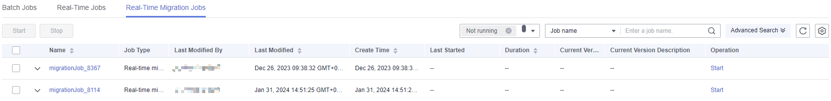

- On the Real-Time Migration Jobs page, click a job name. Figure 1 Monitoring a real-time migration job

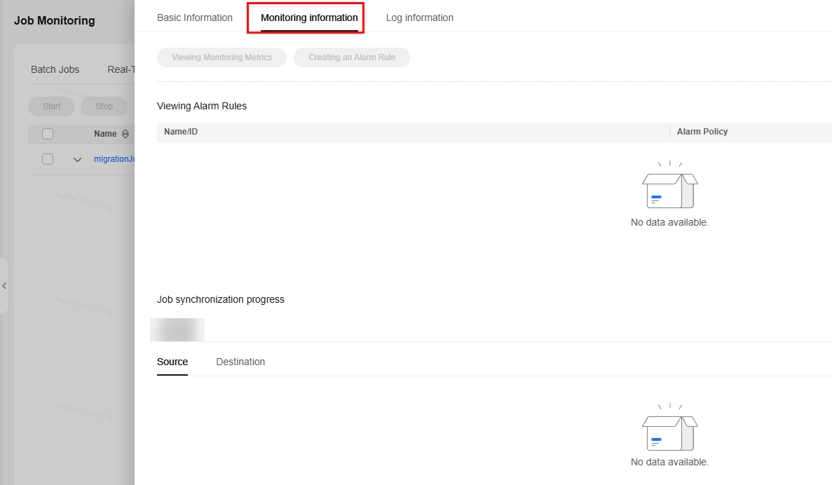

- On the details page, click the Monitoring Information tab. You can view some key metrics of the job at the bottom of the page. Figure 2 Key metrics

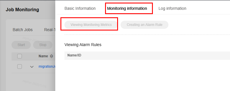

- Click View Monitoring Metrics to go to the Cloud Eye console and view monitoring metrics. Figure 3 Viewing monitoring metrics
