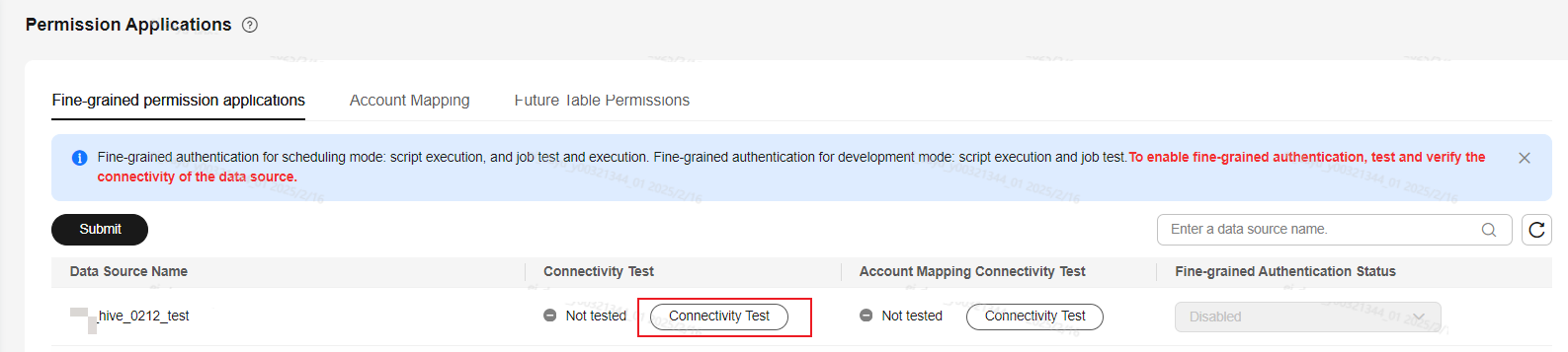

- On the Permission Applications page, test the connectivity of the data connections for which you want to enable fine-grained authentication. During the connectivity test, the system uses the current user account to access the data source to ensure that the current user can access the data source.
- DWS data sources cannot be accessed using a a Huawei account. Therefore, if you log in using a a Huawei account, the connectivity test will fail. Before testing GaussDB(DWS) connectivity, you must synchronize users and switch the current login account to an IAM sub-user account with at least the DWS Database Access permission.
Figure 1 Testing connectivity

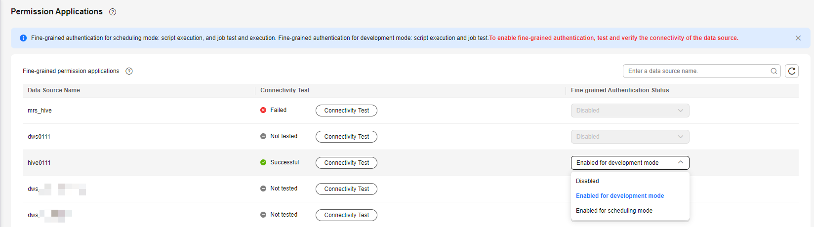

- After the connectivity test is successful, select Enabled for development mode or Enabled for scheduling mode in the Fine-grained Authentication Status column, and click Submit to enable fine-grained authentication.
Figure 2 Enabling fine-grained authentication

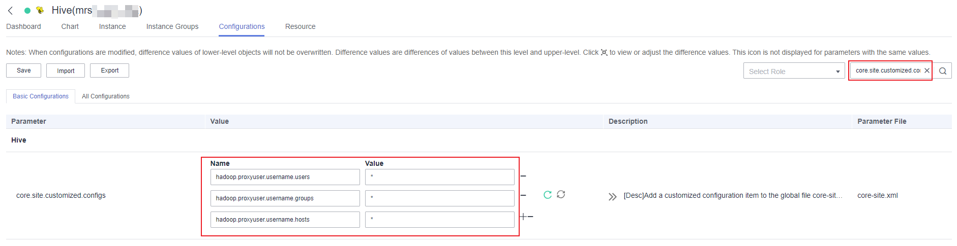

Configuring Hive proxy permissions
- Log in to MRS FusionInsight Manager.
- Choose Cluster > Services > Hive and click Configurations and then Basic Configurations. In the search box, enter core.site.customized.configs and set the parameter listed in Figure 3.
Table 1 Parameter Parameter
Name
Value
hadoop.proxyuser.Username configured for the data connection.users
hadoop.proxyuser.Username configured for the data connection.groups
hadoop.proxyuser.Username configured for the data connection.hosts

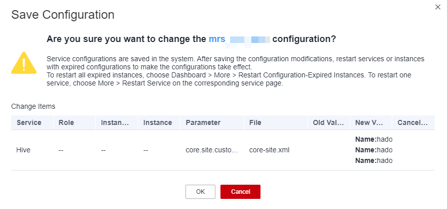

- After setting the parameter, click Save in the upper left corner and then OK in the dialog box to save the configuration.
Figure 4 Saving the configuration

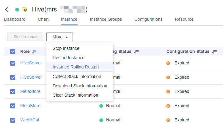

- After saving the configuration, switch to the Instances tab page, select the instance that has expired, click More, and select Instance Rolling Restart to make the configuration take effect.
Figure 5 Performing a rolling instance restart

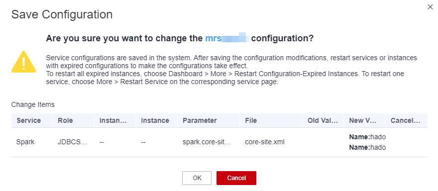

Figure 7 Saving the configuration

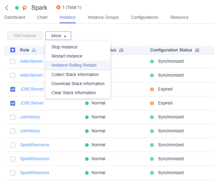

- After saving the configuration, switch to the Instance tab page, select the instance that has expired, click More, and select Instance Rolling Restart to make the configuration take effect.
Figure 8 Performing a rolling instance restart
