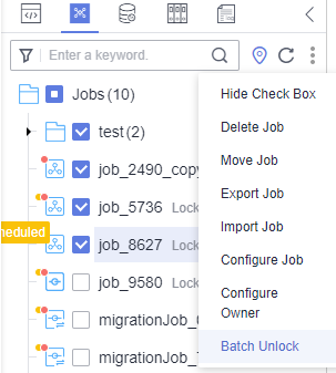

- Click
in the job directory and select Show Check Box. - Select the jobs to unlock, click
, and select Batch Unlock. The message "Unlocked." is displayed. Figure 1 Batch Unlock
