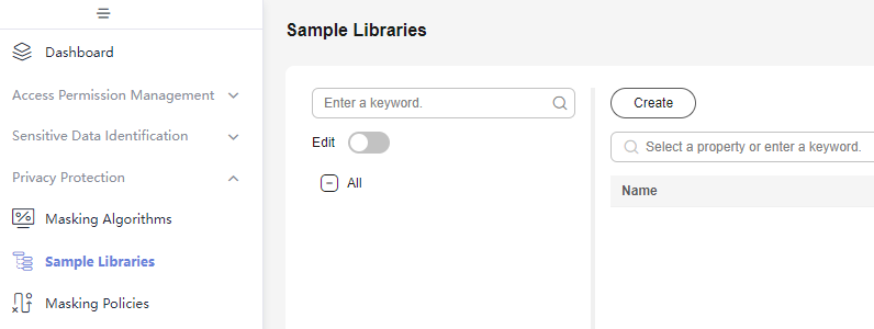

- In the navigation pane on the left, choose Sample Libraries. Figure 1 Sample Libraries page

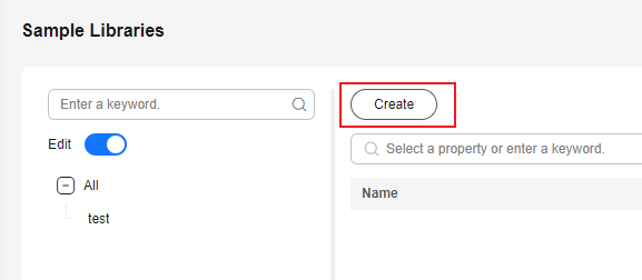

- In the right pane, click Create. The classification selected on the left is set for Classification in the Create dialog box. Figure 3 Creating a sample
- In the displayed dialog box, set the parameters listed in Table 1 and click Confirm. Figure 4 Creating a sample
