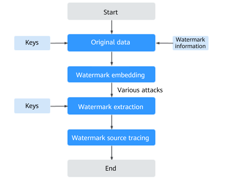

Watermark Use Process
Figure 1 shows the process of using watermarks.

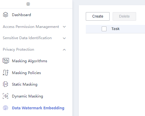

- On the DataArts Studio console, locate a workspace and click DataArts Security.

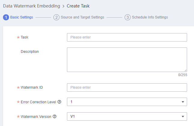

- Choose from the left navigation bar, and click Create in the upper part of the displayed page. Figure 2 Creating a data watermark embedding task
- In the displayed dialog box, set the parameters listed in Table 1.
Table 1 Basic settings Parameter
Description
*Task
Name of the watermark embedding task. The name can only contain letters, digits, underscores (_), and hyphens (-), and can contain a maximum of 64 characters.
To facilitate the management of the watermark embedding task, you are advised to include the object into which you want to embed the watermark and the watermark ID in the name.
Description
A description of the task
*Watermark ID
Watermark ID that will be embedded by the system into data tables. The watermark ID can contain a maximum of 16 characters.
*Error Correction Level
The higher the level, the more bits of watermark information, and the lower bit error rate during source tracing. Note that a higher error correction level requires a larger amount of data to ensure the integrity of embedded information. The default value is 1.
*Watermark Version
V1: Watermarks depend on primary keys, and the embedding speed is fast. If primary keys are attacked, source tracing may fail.
V2: Watermarks do not depend on primary keys. They are related only to embed columns. The embedding speed is slow and the robustness is enhanced.
Figure 3 Configuring basic information

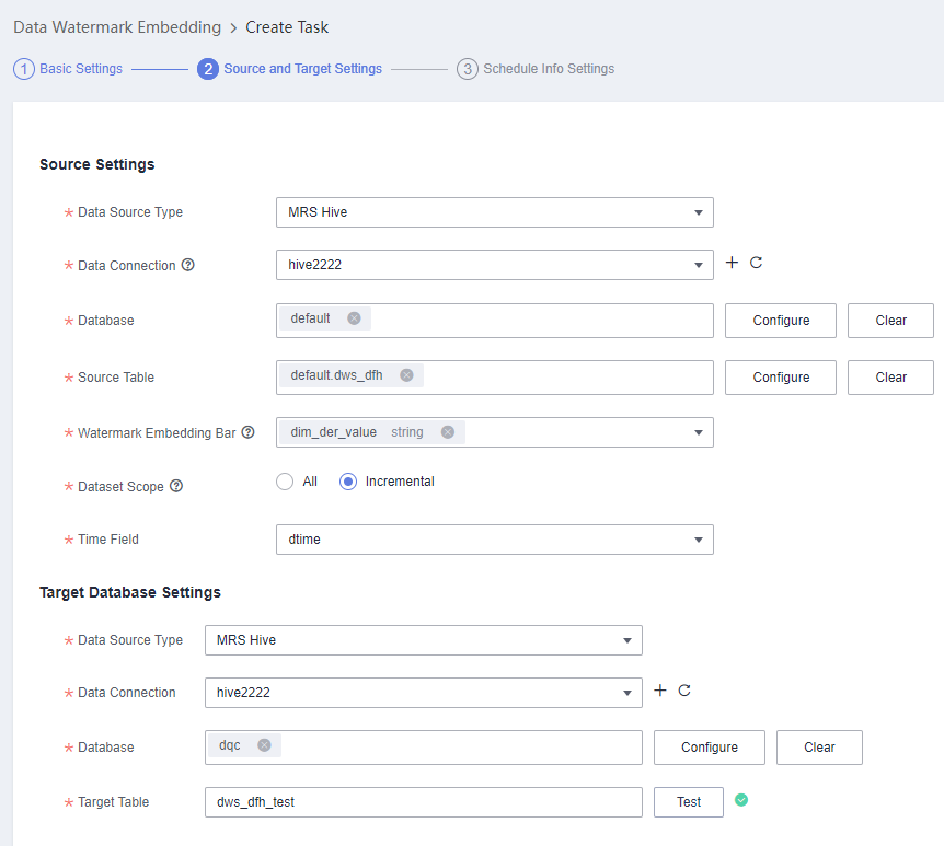

- Click Next to configure the source and target end parameters listed in Table 2.
Table 2 Source and target end parameters Parameter
Description
Source Settings
*Data Source Type
Currently, the value can only be MRS Hive.
*Data Connection
Select a data connection. If no data connection is available, create one by referring to Creating a DataArts Studio Data Connection.
*HTTP/HTTPS Port
This parameter is required for the MRS Doris data source. To obtain the port, perform the following operations: Log in to MRS FusionInsight Manager of the Doris cluster, choose Cluster > Services > Doris, and click Configurations. If Kerberos authentication is enabled for the cluster, enter the value of https_port for this parameter. Otherwise, enter the value of http_port for this parameter.
*Database
Select the databases and tables into which you want to embed the watermark.
- Click Configure to select databases and tables.
- Click Clear to delete the selected databases and data tables.
*Source Table
*Watermark Embedding Bar
Select a field type from the drop-down list as the embedding bar. For example, the value can be a number or a character.
Note that when Watermark Version is set to V1, the primary key column cannot be selected.
*Dataset Scope
If Dataset Scope is set to Incremental, you can set Time Field to Timestamp or Date.
Generally, the watermark embedding task is scheduled once if this parameter is set to All and is scheduled periodically if this parameter is set to Incremental.
*Time Field
If Dataset Scope is set to Incremental, you can set this parameter to Timestamp or Date.
Target End Settings
*Data Source Type
*Data Connection
*HTTP/HTTPS Port
*Database
Select the database where the watermark table is stored from the drop-down list.
*Target Table
Enter a unique table name. The table is automatically created when the table name entered does not exist.
Click Test. Otherwise, the next operation is not allowed.
Figure 4 Configuring source and target information

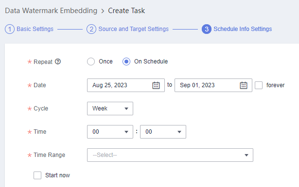

- Click Next and configure scheduling.
- If Dataset Scope is set to All, Repeat can be only set to Once.
- If Dataset Scope is set to Incremental, Repeat can be set to Once or On Schedule.
If you set Repeat to On Schedule, set the parameters listed in Table 3.
Table 3 Parameters for periodic scheduling Parameter
Description
*Date
Period during which the task takes effect.
*Cycle
The frequency at which a task is executed. The options are:
- minutes: Select the scheduling start time and end time, and set the interval in minutes.
- hours: Select the scheduling start time and end time, and set the interval in hours.
- Day: Set the scheduling time everyday.
- Week: Select a day in a week and set the specific time to start scheduling.
- Month: Select a day in a month and set the specific time to start scheduling.
For example, you can set Cycle to Week, Time to 15:52, and Time Range to Tuesday. In this case, the task is executed at 15:52 every Tuesday within the configured date range.
Start now
If you select Start now, the task is scheduled immediately.
Figure 5 Configuring scheduling
