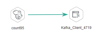

Figure 1 Example job

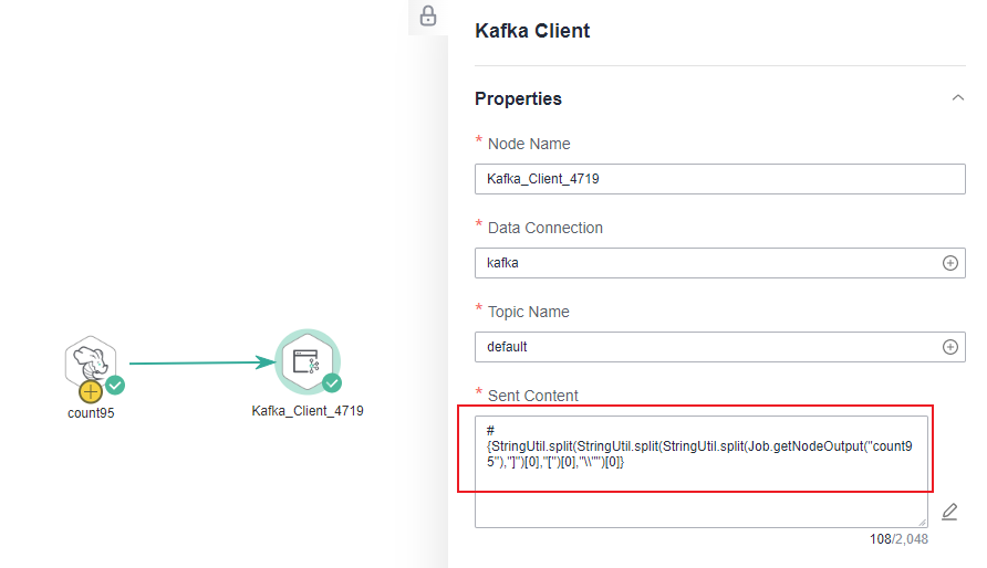

The key configuration of the Kafka Client node is the Sent Content parameter. Set it as follows:
#{StringUtil.split(StringUtil.split(StringUtil.split(Job.getNodeOutput("count95"),"]")[0],"[")[0],"\\"")[0]}

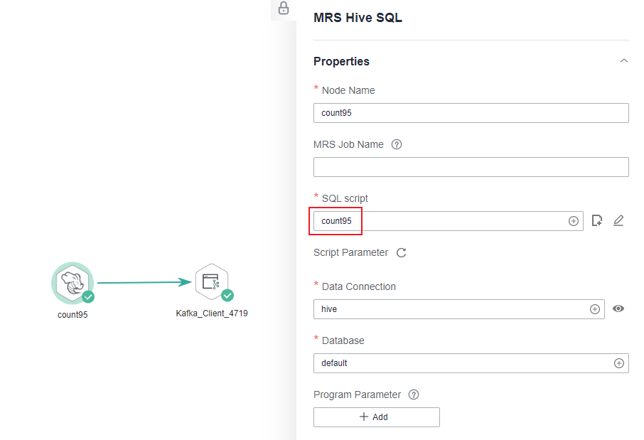

  5. On the Develop Job page, create a data development job. Drag an MRS Hive SQL node and a Kafka Client node and drop them on the canvas. Click and hold to connect the nodes, as shown in Figure 1.
  6. Configuring parameters for an MRS Hive SQL node Select the count95 script submitted in 4 for SQL script and select a Hive connection and database.
    Figure 2 Configuring parameters for an MRS Hive SQL node
  7. Configure parameters for the Kafka Client node. Set Sent Content to #{StringUtil.split(StringUtil.split(StringUtil.split(Job.getNodeOutput("count95"),"]")[0],"[")[0],"\\"")[0]} and select a Kafka connection and a topic name.
    Figure 3 Configuring parameters for the Kafka Client node

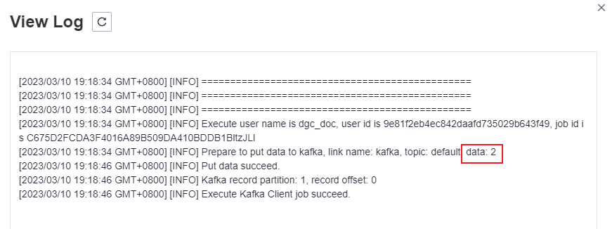

  8. After the node configuration is complete, click Test. After the job test is successful, right-click the Kafka Client node to view its log. You can find that the two-dimensional array [["2"]] returned by the MRS Hive SQL node has been converted to 2.
    You can set Sent Content of the Kafka Client node to #{Job.getNodeOutput("count95")} and run the job. Then you can view the log of the Kafka Client node to verify that the result returned by the MRS Hive SQL node is two-dimensional array [["2"]].
    Figure 4 Check the Kafka Client node logs.

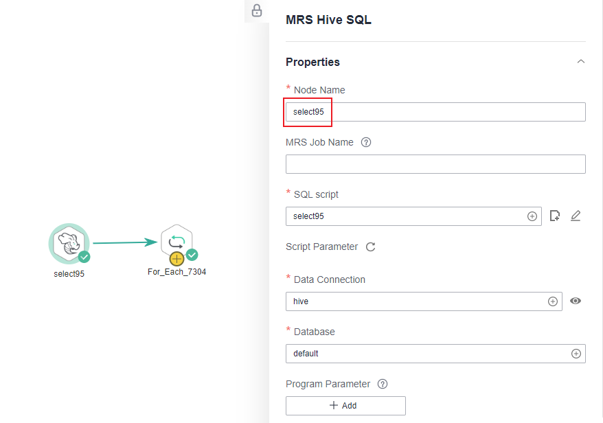

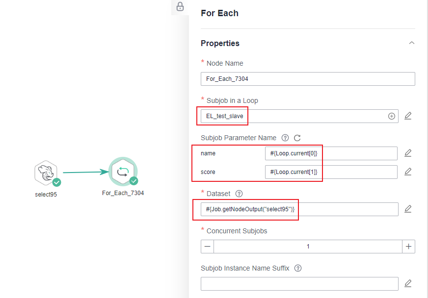

Orchestrate the main job shown in Figure 5. Key configurations of the For Each node are as follows:
  • Dataset: Enter the execution result of the select statement on the Hive SQL node. Use the #{Job.getNodeOutput("select95")} expression, where select95 is the name of the previous node.
  • Subjob Parameter Name: Enter the parameter name defined in the subjob. Transfer the parameter value defined in the main job to the subjob. Set the subjob parameter names to name and score, whose values are those in the first and second columns in the dataset, respectively. EL expressions #{Loop.current[0]} and #{Loop.current[1]} are used.
Figure 5 Example main job

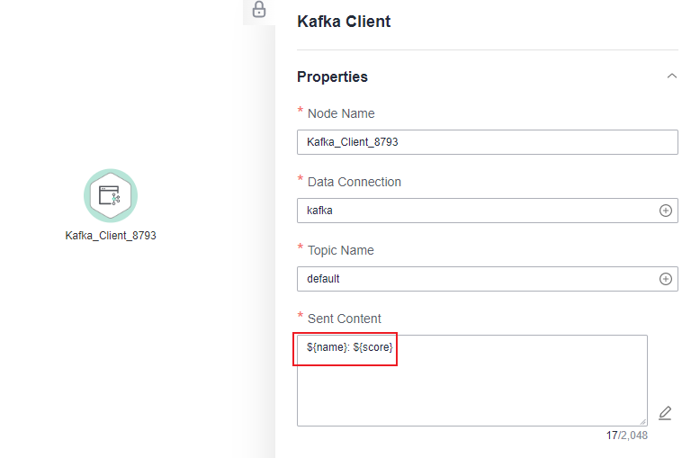

  3. On the Develop Job page, create a data development subjob named EL_test_slave. Select a Kafka Client node, configure job parameters, and orchestrate the job shown in Figure 6.

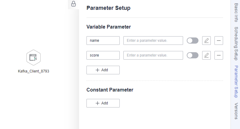

    Set the parameter name to name and score. This parameter is only used by the For Each node in the main job to identify subjob parameters. You do not need to set the parameter value.
  4. Configure parameters for the Kafka Client node. Set Sent Content to ${name}: ${score} and select a Kafka connection and a topic name.
    Do not use the #{Job.getParam("job_param_name")} EL expression because this expression can only obtain the values of the parameters configured in the current job, but cannot obtain the parameter values transferred from the parent job or the global variables configured in the workspace. The expression only works for the current job.
    To obtain the parameter values passed from the parent job and the global variables configured for the workspace, you are advised to use the ${job_param_name} expression.
    Figure 7 Configuring parameters for the Kafka Client node

  5. Configure parameters for the MRS Hive SQL node. Select the select95 script submitted in 3 for SQL script and select a Hive connection and database.

  6. Configure properties for the For Each node.
    • Subjob in a Loop: Select EL_test_slave, the subjob that has been developed.
    Figure 9 Configuring properties for the For Each node

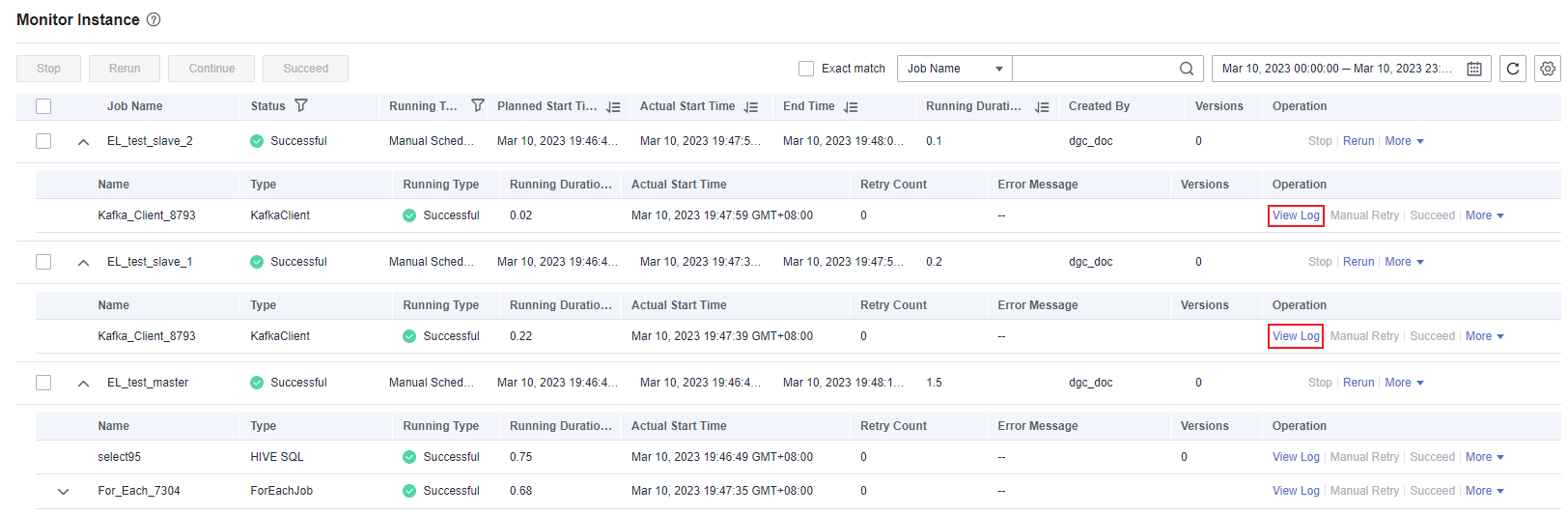

  1. Click Test above the main job EL_test_master canvas to test the job. After the main job is executed, the subjob EL_test_slave is cyclically invoked through the For Each node and executed.
  2. In the navigation pane on the left, choose Monitor Instance to view the job execution result.
  3. After the job is executed, view the cyclic execution result of the subjob EL_test_slave on the Monitor Instance page.
    Figure 10 Execution result of the subjob

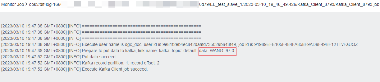

  4. View the log of the cyclic execution of subjob EL_test_slave. The log shows that the output values of the previous node of the For Each node was obtained through the For Each node and the EL expression with a Loop embedded object.
