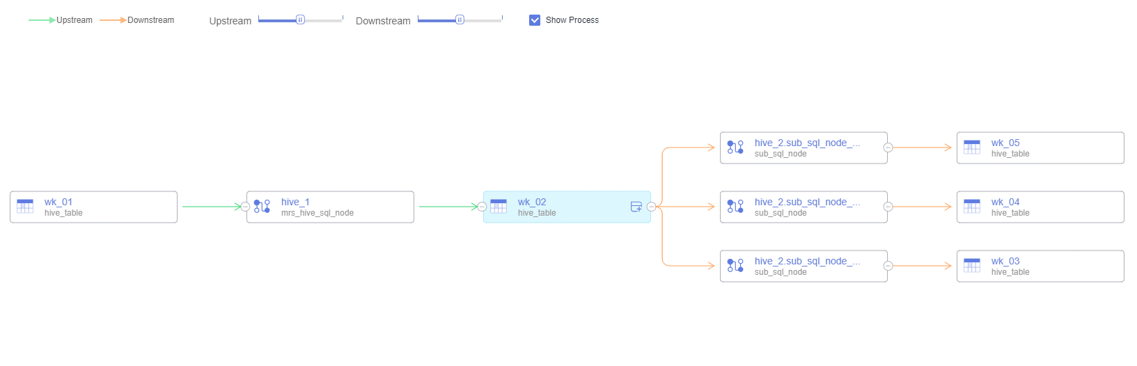

indicates a data table, and
indicates a job node. They are orchestrated using arrows. As shown in the graph, the data in table wk_01 is processed on the hive_1 job node and then written to table wk_02. The data in table wk_02 is processed on the hive_2 job node and written to tables wk_03, wk_04, and wk_05, respectively. How DataArts Studio Data Lineage Is Implemented
