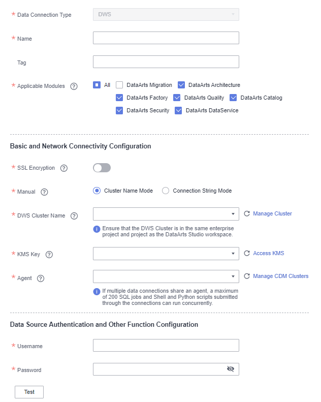

    Figure 1 Creating a data connection
  4. On the Manage Data Connections page, click Create Data Connection. On the displayed page, select DWS for Data Connection Type and set other parameters based on the descriptions in Table 1.
    Figure 2 DWS connection parameters
    Table 1 DWS connection
    Parameter
    Mandatory
    Description
    Yes
    DWS is selected and cannot be changed.
    Name
    Yes
    Name of the data connection to create. Data connection names can contain a maximum of 100 characters. They can contain only letters, digits, underscores (_), and hyphens (-).
    Tag
    No
    Attribute of the data connection to create. Tags make management easier.
    NOTE:
    The tag name can contain only letters, digits, and underscores (_) and cannot start with an underscore (_) or contain more than 100 characters.
    Applicable Modules
    Yes
    Select the modules for which this connection is available.
    Basic and Network Connectivity Configuration
    SSL Encryption
    Yes
    DWS supports SSL encryption and certificate authentication for communication between the client and server. You can set this parameter based on whether SSL connection is mandatory on the server.
    • If this parameter is enabled, only SSL encryption can be used for communication.
    • If this parameter is disabled, both SSL encryption and certificate authentication can be used for communication.
    Manual
    Yes
    Select either of the following modes:
    • Cluster Name Mode: Select an existing cluster.
    • Connection String Mode: Enter the IP address/domain name and port of the corresponding cluster and enable the communication between the connection's agent (CDM cluster) and the DWS cluster.
    NOTE:
    DataArts Security does not support GaussDB(DWS) connections in connection string mode.
    DWS Cluster Name
    Yes
    This parameter is mandatory when Manual is set to Cluster Name Mode.
    Select a DWS cluster from all the DWS clusters with the same project ID and enterprise project.
    IP Address or Domain Name
    Yes
    This parameter is mandatory when Manual is set to Connection String Mode.
    If you choose to manually enter an IP address or domain name, you must enter an internal IP address and a port that is accessible to the network segment of the resource group. Otherwise, the network is disconnected.
    This parameter indicates the address for accessing the cluster database through an internal network. Enter an IP address or domain name. The IP address or domain name is automatically generated during cluster creation. You can obtain them on the management console by performing the following operations:
    1. Log in to the GaussDB(DWS) console.
    2. In the left navigation pane, choose Instances.
    3. Click the name of an instance to enter the basic information page. In the Connection Information area, you can obtain the private IP address, domain name, and port number.
    Port
    Yes
    This parameter indicates the database port number specified during the DWS cluster creation. Ensure that you have enabled this port in the security group rule so that the DataArts Studio instance can connect to the database in the DWS cluster through this port.
    KMS Key
    Yes
    KMS key used to encrypt and decrypt data source authentication information. Select a default or custom key.
    NOTE:
    • When you use KMS for encryption through DataArts Studio or KPS for the first time, the default key dlf/default or kps/default is automatically generated. For more information about default keys, see What Is a Default Master Key?.
    • Only symmetric keys are supported. Asymmetric keys are not supported.
    Agent
    Yes
    Data Warehouse Service (DWS) is not a fully managed service and thus cannot be directly connected to DataArts Studio. A CDM cluster can provide an agent for DataArts Studio to communicate with non-fully-managed services. Therefore, you need to select a CDM cluster when creating a DWS data connection. If no CDM cluster is available, create one first by referring to Creating a CDM Cluster.
    As a network proxy, the CDM cluster must be able to communicate with the DWS cluster. To ensure network connectivity, the CDM cluster must be in the same region and AZ and use the same VPC and subnet as the DWS cluster. The security group rule must also allow the CDM cluster communicate with the DWS cluster.
    NOTE:
    If a CDM cluster functions as the agent for a data connection in Management Center, the cluster supports a maximum of 200 concurrent active threads. If multiple data connections share an agent, a maximum of 200 SQL, Shell, and Python scripts submitted through the connections can run concurrently. Excess tasks will be queued. You are advised to plan multiple agents based on the workload.
    Data Source Authentication and Other Function Configuration
    Username
    Yes
    The database username, which is specified when the DWS cluster is created.
    Password
    Yes
    The password for accessing the database, which is specified when the DWS cluster is created.
  5. Click Test to test connectivity of the data connection. If the test fails, the data connection fails to be created.
  6. After the test is successful, click Save to create the data connection.

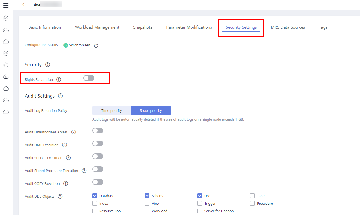

  1. What should I do if the connection test fails when I enable the SSL connection during the creation of a DWS data connection?
    On the DWS console, click the corresponding cluster, choose Security Settings, and disable Rights Separation.
    Figure 3 Disabling Rights Separation for the DWS cluster
