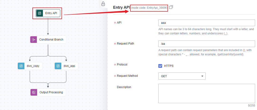

| Result Set Mappings | Yes | The result set names of one or more Common API operators can be mapped to custom names which will be used in the JSON string or file name. Result sets that are not mapped will not be output to the final returned result. The node mapping expression is in ${Node code|payload} format. You can obtain the node code by clicking a node in the API orchestration canvas, and copy the code by clicking Figure 1 Viewing the node code For example, if the node code is NormalApi_5a256, set the node mapping expression to ${NormalApi_5a256|payload} and the result set name to sales record. |
