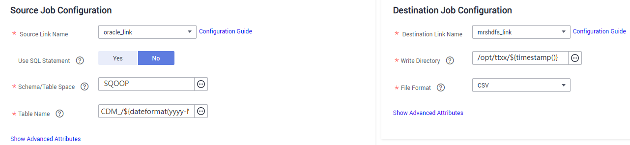

Figure 1 shows an example. If:
  • Table Name under Source Link Configuration is set to CDM_/${dateformat(yyyy-MM-dd)}.
  • Write Directory under Destination Link Configuration is set to /opt/ttxx/${timestamp()}.
After the macro definition conversion, this job indicates that data in table SQOOP.CDM_20171016 in the Oracle database is migrated to the /opt/ttxx/1508115701746 directory of the HDFS server.
Figure 1 Setting Table Name and Write Directory to a time and date macro variable
Currently, a table name or path name can contain multiple macro variables. For example, /opt/ttxx/${dateformat(yyyy-MM-dd)}/${timestamp()} is converted to /opt/ttxx/2017-10-16/1508115701746.

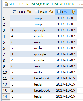

Time and Date Macro Variables in the Where Clause
Figure 2 uses table SQOOP.CDM_20171016 as an example. The table contains column DS, which indicates the time.
Figure 2 Table data
Suppose that the current date is 2017-10-16 and you want to export data generated the day before the current day (DS = 2017-10-15), then you can set the value of Where Clause to DS='${dateformat(yyyy-MM-dd,-1,DAY)}' when creating a job. In this way, you can export all data that complies with the DS = 2017-10-15 condition.
