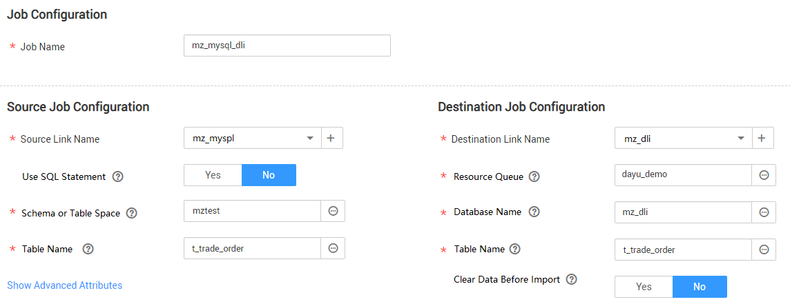

- Create a table/file migration job, and select the created source connector and destination connector. Figure 1 Configuring the job

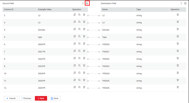

- Click Next to go to the Map Field page and click
. Figure 2 Configuring field mapping

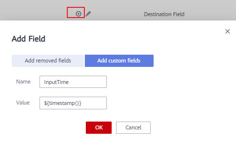

- Click the Custom Fields tab, set the field name and value, and click OK.
Name: Enter InputTime.
Value: Enter ${timestamp()}. For more time macro variables, see Table 1.Figure 3 Add Field
