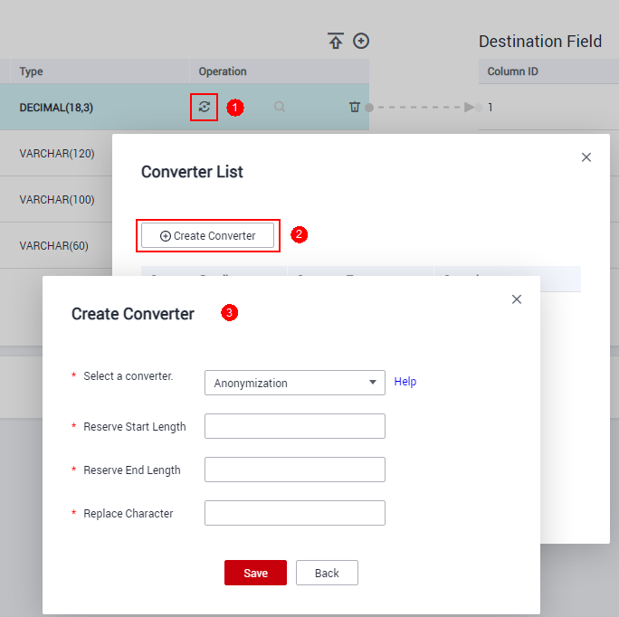

CDM can convert fields during migration. Currently, the following field converters are supported:
Anonymization
- Set Reserve Start Length to 3.
- Set Reserve End Length to 4.
- Set Replace Character to *.
![](https://support.huaweicloud.com/eu/usermanual-dataartsstudio/en-us_image_0108275435.png)

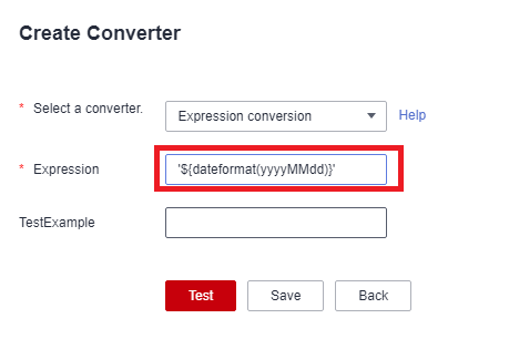

Expression Conversion
This converter uses the JSP expression language (EL) to convert the current field or a row of data. The JSP EL is used to create arithmetic and logical expressions. Within a JSP EL expression, you can use integers, floating point numbers, strings, the built-in constants true and false for boolean values, and null.
- value: indicates the current field value.
- row: indicates the current row, which is an array type.
- StringUtils: string processing tool class. For details, see org.apache.commons.lang.StringUtils of the Java SDK code.
