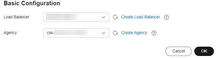

Connecting a Cluster to a Load Balancer
  1. Log in to the CSS management console.
  2. On the Clusters page, select the cluster you want to connect to the load balancer and click the cluster name. The cluster information page is displayed.
  3. In the navigation pane, choose Load Balancing. Toggle on Load Balancing and configure basic load balancing information.
    Table 4 Configuring load balancing
    Parameter
    Description
    Load Balancer
    Select a dedicated load balancer created earlier. A CSS cluster is a managed resource. The selected load balancer becomes available only after IP as Backend Servers is enabled.
    Agency
    Select an IAM agency to authorize CSS to access and use ELB resources using the current account. The selected agency must include the ELB Administrator or ELB FullAccess policy.
    Figure 1 Enabling load balancing
  4. Click OK to enable load balancing.

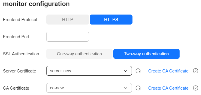

  5. In the Listener Configuration area, click to configure listener information.
    Table 5 Listener configuration
    Parameter
    Description
    Frontend Protocol
    Protocol used by the client and listener to distribute traffic. Select HTTP or HTTPS.
    Select a protocol as required.
    Frontend Port
    Port used by the client and listener to distribute traffic.
    Set this parameter based on site requirements.
    SSL Authentication
    Authentication mode for the client to access the server. Set this parameter only when Frontend Protocol is set to HTTPS.
    Select an authentication mode that suits your needs.
    Server Certificate
    The server certificate is used for SSL handshake. The certificate content and private key must be provided. It is required only when Frontend Protocol is set to HTTPS.
    Select the server certificate created in Preparing and Uploading a Self-Signed Certificate.
    CA Certificate
    Also called client CA public key certificate. It is used to verify the issuer of a client certificate. It is required only when SSL Authentication is set to Two-way authentication.
    Select the CA certificate created in Preparing and Uploading a Self-Signed Certificate.
    When HTTPS two-way authentication is enabled, an HTTPS connection can be established only when the client can provide the certificate issued by a trusted CA.
    Figure 2 Listener configuration
