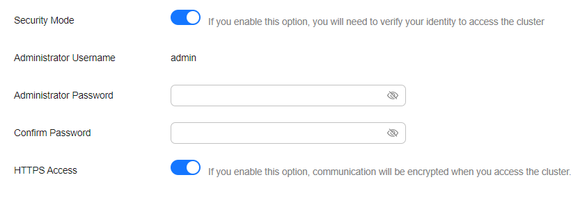

  5. Enable the security mode. Enter and confirm the administrator password of the cluster.
    Figure 1 Enabling the security mode
  6. Enable or disable HTTPS Access.
    • If you enable HTTPS Access, HTTPS is used to encrypt cluster communication, and public network access can be enabled for the cluster.
    • If you disable HTTPS Access, HTTP is used, and public network access is disallowed for the cluster.
  7. Click Submit, and confirm the information. The cluster list is displayed.
    The Task Status of the cluster is Changing security mode. When the cluster status changes to Available, the security mode has been successfully changed.

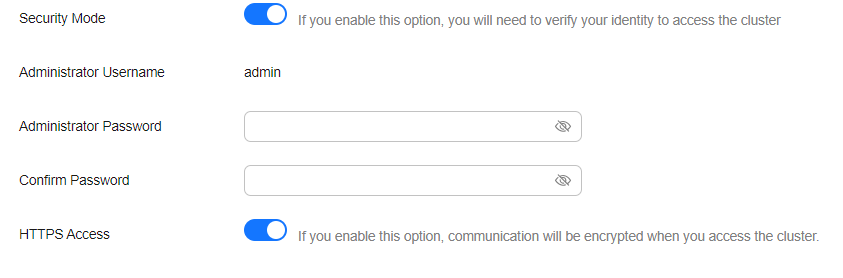

  5. Disable the security mode.
    Figure 2 Disabling the security mode
  6. Click Submit. In the displayed dialog box, confirm the information. The cluster list page is displayed.
