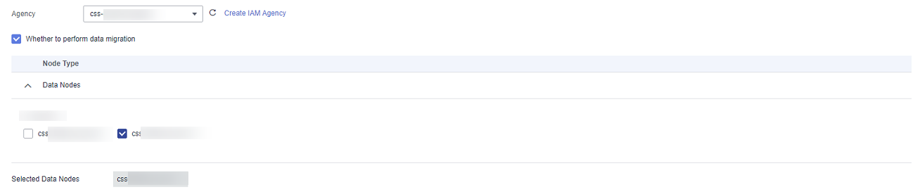

  4. On the Modify Configuration page, click the Replace Node tab.
  5. On the Replace Node tab, set the parameters as needed.
    Table 1 Replacing a specified node
    Parameter
    Description
    Node Type
    Select the node you want to replace. You can expand a node type to check all the nodes under it.
    Figure 1 Replacing a specified node
  6. Click Submit. In the data migration confirmation dialog box, choose to migrate data, and click OK.
