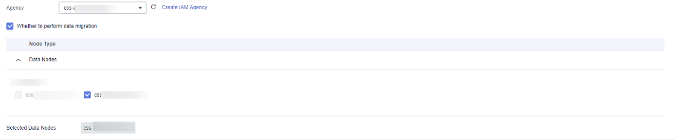

Removing Specified Nodes
  1. Log in to the CSS management console.
  2. In the navigation pane on the left, choose Clusters > Elasticsearch.
  3. In the cluster list, find the target cluster, and choose More > Modify Configuration in the Operation column. The Modify Configuration page is displayed.
  4. On the Modify Configuration page, click the Scale In Nodes tab.
  5. Set scale-in parameters.
    Table 4 Removing specified nodes (Scale In Nodes)
    Parameter
    Description
    Node Type
    Expand the node type that needs be changed to show all nodes under it. Select the nodes you want to remove.
    Figure 1 Removing specified nodes
  6. Click Next.
  7. Confirm the change information and click Submit. In the confirm dialog box, choose to migrate data, which helps to prevent data loss, and click OK.
    During data migration, the system migrates all data from the to-be-removed nodes to the remaining nodes, and removes these nodes upon completion of the data migration. If the data on the to-be-removed nodes has replicas on other nodes, data migration can be skipped and the cluster change can be completed faster.
  8. Click Back to Cluster List to go back to the Clusters page. Task Status is Scaling in. When Cluster Status changes to Available, the cluster has been successfully scaled in.
