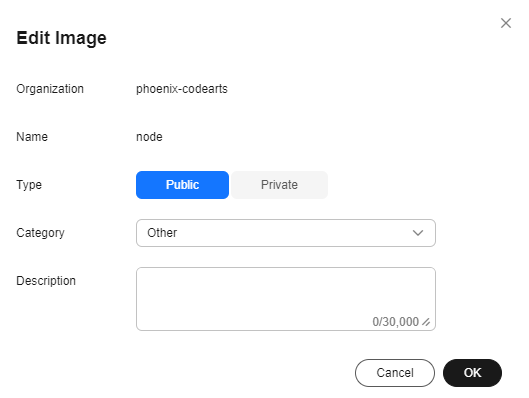

- In the navigation pane, choose My Images, click the image name to go to the image details page, and click Edit in the upper right corner.
- In the displayed dialog box, set Type to Public and click OK.
Figure 1 Editing an image

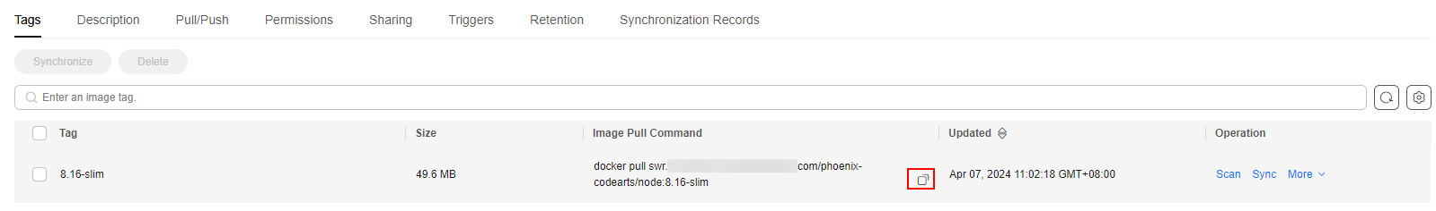

- To obtain the complete image path, click
to copy the image download command. The part following docker pull is the image path.
