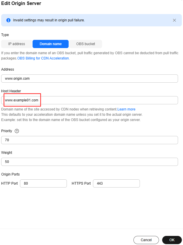

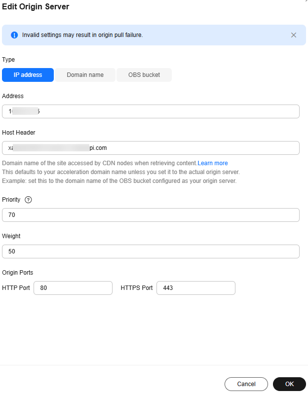

- In the Origin Server Settings area, click Edit in the Operation column of the row containing the target origin server. Figure 1 Editing the origin server
- Enter the domain name of the host and click OK.
Each label of a domain name (for example, *** in ***.***.com) can contain up to 63 characters.
- To edit host headers in a batch, click Edit above the origin server list.
In the Host Header column, modify the information and click Save.

Assume that you have an acceleration domain name www.example.com. Its origin server domain name is www.origin.com, and the host is www.example01.com.
When a user requests the http://www.example.com/test.jpg file, the file is not cached on CDN, and CDN pulls that file from the origin server www.origin.com whose IP address is 192.168.1.1. The file is found in the www.example01.com site of the origin server. CDN then returns the file to the user, and caches the file on PoPs.
