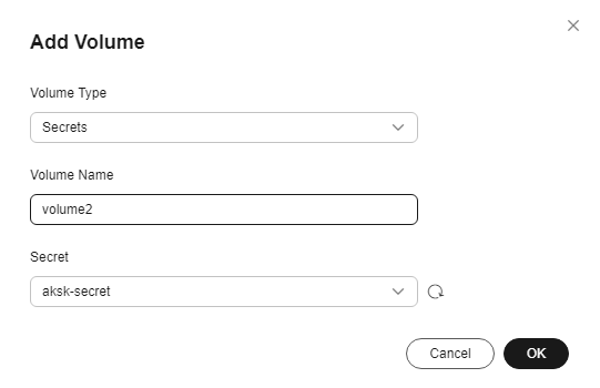

After a secret is created, you can mount it to a container as a storage volume during pod creation. For example, mount a secret named aksk-secret to a container and set the storage volume name to volume2.
