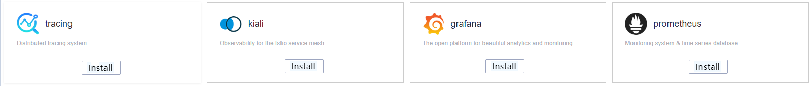

  • Check add-ons. (This check is not required for 1.8 and later versions.)
    The add-ons supported in 1.3 and 1.6 are no longer supported in 1.8 and later versions. Before the upgrade, uninstall the add-ons.
