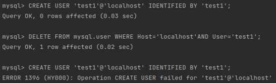

Troubleshooting example:
After an account is created, the delete statement is used to delete the account. When a new account with the same name as the disappeared account is created, error 1396 is reported. After the flush privileges command is executed, an account with the same name can be created.
