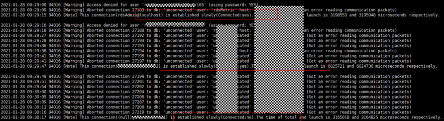

During peak hours, the connection between a client and a TaurusDB instance often times out. As a result, it takes more than 10 seconds to log in to the instance.
Possible Causes
  1. View error logs of the TaurusDB instance to check whether the error message "connection xxx is established slowly" is displayed. Example:
    If yes, some connections have timed out and have not been processed yet. When the connection between a client and the instance exceeds the specified timeout duration, an error is reported.
