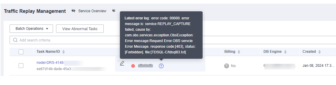

When you create a to-the-cloud workload replay task and obtain workload files in the OBS bucket using an AK/SK, workload files failed to be parsed and a message is displayed indicating that the OBS connection failed.
Figure 1 Parsing failed
