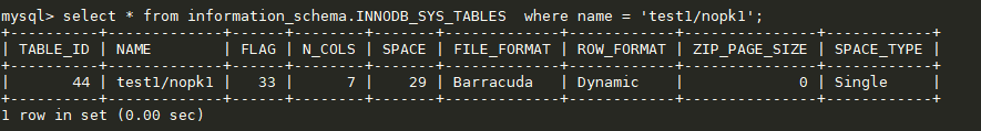

- Use an account with the process permission to run the following SQL statement at the source end to query table information. In the statement, database/table indicates the database name and table name of a table without a primary key. If the table is a partition table, use the like statement.
select * from information_schema.INNODB_SYS_TABLES where name = 'database/table';

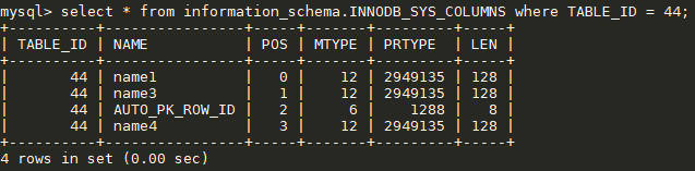

- Run the following SQL statement to query the column information of the table without a primary key based on TABLE_ID obtained in 1:
select * from information_schema.INNODB_SYS_COLUMNS where TABLE_ID = 44;
- According to the query result, the third column whose POS is 2 is the hidden auto-increment primary key column. If the hidden primary key column in binlog is not the last column, DRS synchronization will fail.
