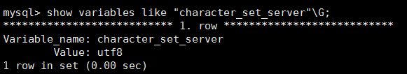

- Run the following command to check the character set of the database:
SHOW VARIABLES LIKE "character_set_server"\G;
- Modify the character set of the source database server.
SET character_set_server='utf8';
