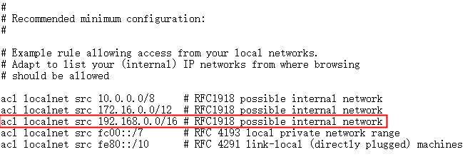

- Configure Squid as a proxy for the network segment where the source server is located. Replace 192.168.0.0/16 with the private IP address of the server that needs to access the proxy server. Generally, it is set to the private network segment of the source server. You can also set it to 0.0.0.0/0 to allow access from all servers.
acl localnet src 192.168.0.0/16

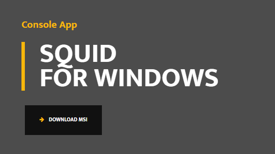

- On the server you prepared, access https://squid.diladele.com. Locate Console APP, download the installation program, and install it.

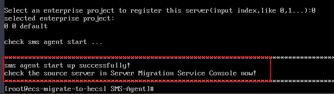

- Go to the SMS-Agent installation directory and run the startup.sh script to start the SMS-Agent. When prompted, enter the AK/SK pair of your target Huawei Cloud account and the SMS domain name.
When the following information is displayed, the SMS-Agent has been started up and will automatically start reporting source server information to SMS.
