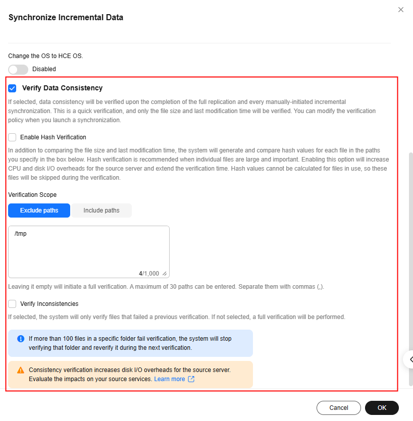

Enabling Data Consistency Verification When You Initiate an Incremental Synchronization
  1. Open the Sync Incremental Data page by referring to Synchronizing Incremental Data.
  2. Select Verify Data consistency. This is a quick verification, and only the file size and modification time will be compared.
    Figure 1 Enabling data consistency verification
    Configure the verification policy based on the following table and your actual requirements.
    Parameter
    Description
    Enable Hash Verification
    If this option is enabled, the system will generate and compare hash values for each file to be verified. Hash verification is recommended when individual files are large and important. Enabling this option will increase CPU and disk I/O overheads for the source server and extend the verification time.
    CAUTION:
    • Hash values cannot be calculated for files in use, so these files will be skipped during the verification.
    • Enabling this option requires you to specify the verification scope, and only files in the specified scope will be verified.
    Verification Scope
    • Under Exclude paths, enter the paths you want to exclude from the verification. A maximum of 30 paths can be entered. Use commas (,) to separate the paths. For example, /root/data,/var. Leaving it empty will initiate a full verification.
    • Under Include paths, enter the paths you want to verify.
    NOTICE:
    • If the entered paths are incorrect or empty, 0 will be displayed for them in the verification results.
    • The more data you need to verify, the longer the verification will take. It is wise to narrow the verification scope to only key paths.
    • The following paths will be excluded from consistency verification by default:
      • Linux: /bin, /boot, /dev, /home, /etc, /lib, /media, /proc, /sbin, /selinux, /sys, /usr, /var, /run, and /tmp
      • Windows: top-level directories of partitions, for example, C:\ and O:\
      If you want to verify some of the excluded paths, see Modifying the Default Excluded Paths.
    Verify Inconsistencies
    This option can only be enabled after at least one consistency verification is complete. If this option is enabled, the system verifies only the files were found to be inconsistent during the last verification.
  3. Click OK to synchronize incremental data and verify consistency. After the synchronization and verification are complete, you can view the verification results by referring to Viewing Verification Results.

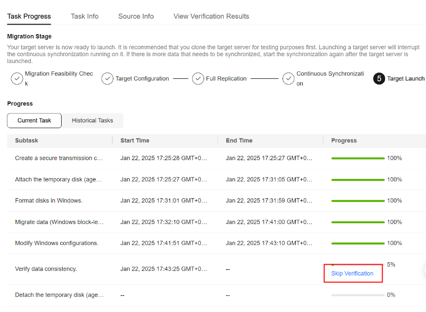

Skipping Consistency Verification
If you want to skip consistency verification after the incremental synchronization starts, perform the following steps:
  1. In the server list, click the server name. The task details show up on the right.
  2. On the Task Progress tab, locate the Verify data consistency subtask and click Skip Verification under the progress bar. In this displayed window, click OK.
    Figure 2 Skipping consistency verification
    Consistency verification can be skipped only when the progress is between 5% and 95%.

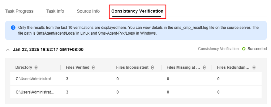

After the verification is complete, go to the task details page and click the Consistency Verification tab to view the verification results.
Figure 3 Viewing verification results
If 0 is displayed in the Files Verified column, it means the specified directory could not be found or is empty.
All files verified to be inconsistent are recorded in the log file sms_cmp_result.log in the SMS-Agent installation directory (*/SmsAgent/agent/Logs/ on Linux and C://SMS-Agent-Py*/Logs on Windows) on the source server.
