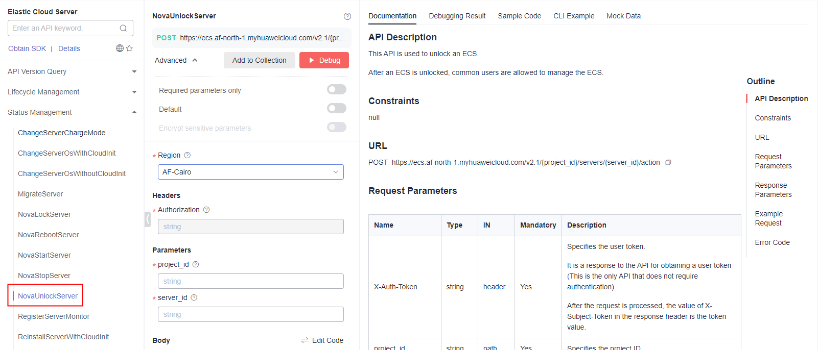

  2. If the server record has been deleted, unlock the target server using the API Explorer.
    1. Log in to the API Explorer.
    2. Set the following parameters:
      • Region: Select the region where the target server is located.
      • Project_id: indicates the project ID, which is automatically filled after login. You can leave it blank.
      • server_id: Specify the ID of the server to be unlocked.
      • unlock: Select (empty) from the drop-down list.
      Figure 1 Unlocking a cloud server
