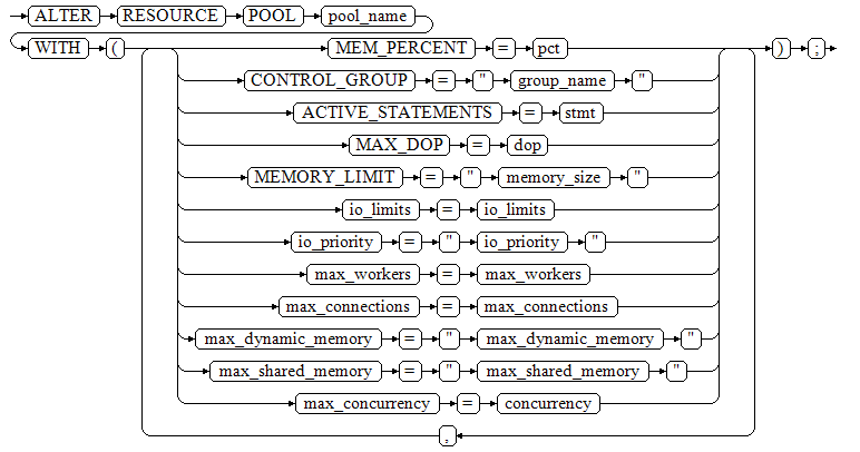

Syntax
2
ALTER RESOURCE POOL pool_name
    WITH ({MEM_PERCENT= pct | CONTROL_GROUP="group_name" | ACTIVE_STATEMENTS=stmt | MAX_DOP = dop | MEMORY_LIMIT="memory_size" | io_limits=io_limits | io_priority="io_priority" | max_worker=max_worker | max_connections=max_connections | max_dynamic_memory="max_dynamic_memory"| max_shared_memory="max_shared_memory" | max_concurrency=concurrency}[, ... ]);
